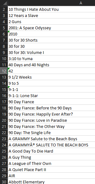

        When i search through one of my installs with Notepad++, here's an example of how it looks when i 1st search for strCollection and then strTitle:
        Then i took the results, manipulated them with sorts, search and replaces, and deleting duplicate lines to go from 600,000+ lines down to 860 lines that give me a list of all Movies and TV Shows.
        Of course, stuff downloaded with DRM MPD, DRM M3U8 and Youtube have individual names so they could be episodes or movies.
        All in all, took 5 minutes to make this text file that can easily be imported into Excel:
