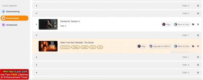

            By the way, the Downloaded list is now filled with hundreds (perhaps thousands) of single-item entries. They appear to be prior HBOMax downloads that the updated StreamFab has unsuccessfully attempted to merge ​with the new Max downloads.
            Click image for larger version  Name:	Downloaded.jpg Views:	0 Size:	17.5 KB ID:	426604
