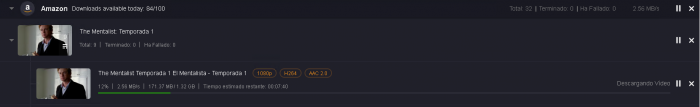

    PrimeVideo downloads are VERY VERY SLOW, I've been downloading the series "The Mentalist" all night and barely downloaded 14 episodes of the first season. It is totally absurd the speed, at this rate it will take me weeks to download the whole series. It is NOT a problem with my internet connection, my speed is very high when downloading from Netflix, HBOMax, Disney+. The problem is with PRIME VIDEO and also PARAMOUNT+. I don't know if it happens with other providers but those are the ones that have a VERY SLOW DOWNLOAD SPEED.

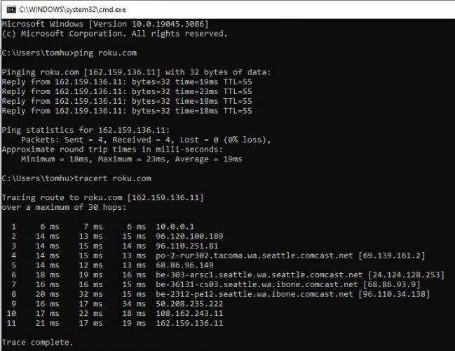

      Right now, I'm using the Roku channel and downloading Space1999 epidsodes. Right now it is reporting about 25 kbps, when it should be up in the 14 or 15 mbps
      Internet speed tests Using infinity (my internet provider) reports 94.5 mbps. That's using the same computer I'm currently running with StreamFab.
      Running ping and tracert do not show anything unusual, so is this a StreamFab problem? Normally I would not think so, but what I'm experiencing and what I've seen in my testing suggests that it isn't the software. BUT . . .

              It took some doing. I started with going after the Roku Channel, but ping would not work and after some work, I realized I was dealing with roku.com. Pinging roku.com got me the IP address and so did tracert. (Windows 10)

                I really don't think that your CDN is just Roku.com. It wouldn't be something that simple but I give you high praise for your effort. I've got my hands full with something else right now but sometime later I'll try finding my CDN for an episode of Space1999 on the Roku Channel. It probably won't be your CDN since you live on the West Coast and I live on the East but at least I'll be able to show you (and hopefully everyone else here with slowness problems) how to determine where the slowness is coming from.
                  Ya you're right. That is not really how it works.

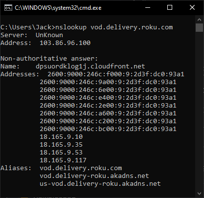

                  The main domain and the CDN are always different. You need to look at the .mpd file to see where the media is being served from.
                  I just went right now and played the 1st episode of Space 1999 and the .mpd file tells me the CDN is actually vod.delivery.roku.com
                  It obviously has a different IP address than roku.com because they actually use a bunch of different CDNs.
                  First time i did an nslookup, it resolved to Akamai.​
                  Second time was Cloudfront:

                  My suggestion to you would be that if you find the CDN you are connecting to is slow then just flush your DNS and try again until it gets faster (if it ever does)​.
                    Third time it was Fastly:
