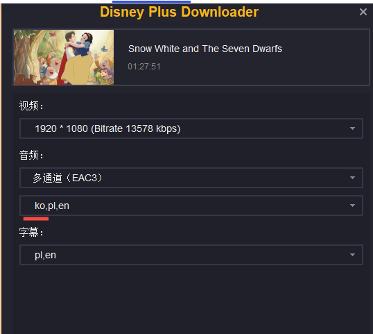

    (BUG 12) for some movies the 'Korean' audio track gets pre-selected ('Snow White and the Seven Dwarves (1937)')

                [StreamFab 6.1.3.2 Disney+]
                (BUG 12) for some movies the 'Korean' audio track gets pre-selected ('Snow White and the Seven Dwarves (1937)')​
                (BUG 15) sometimes the option for 'Stereo (AAC)' gets lost and 'Multichannel (EAC3)' is pre-selected instead​
                These two are duplicated.

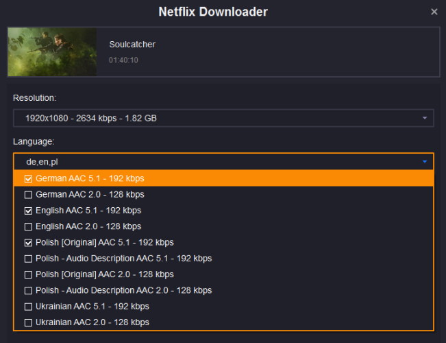

                  (BUG 19) occurs for literally everything for me, here's an example screenshot from 6.1.3.3, with AAC 5.1 instead of AAC 2.0 selected; maybe this specific to Netflix from Poland?:

                    I don't know how (BUG 12) and (BUG 15) are 'duplicated' as they are about two different things - it just happens that they sometimes occur simultaneously.

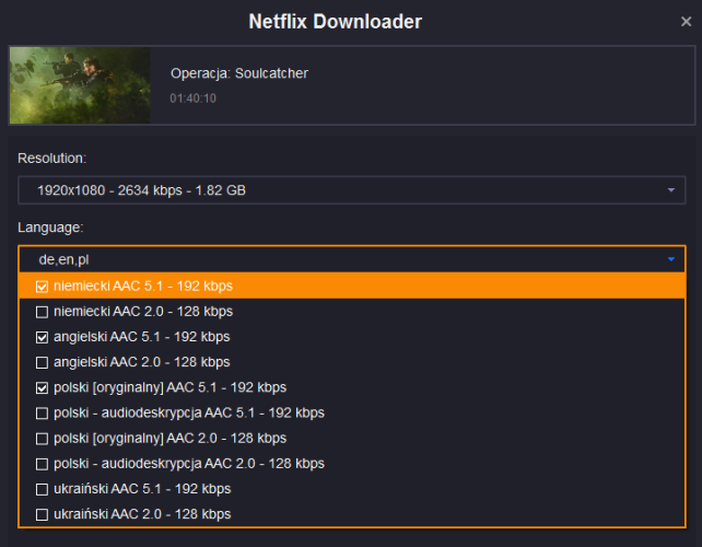

                      (BUG 19) still occurs for me after switching the Netflix profile language from Polish to English:
