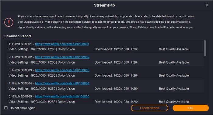

    This is rather odd. I can't get anything in HEVC from Netflix anymore. I do get a notice at the end of each series.
    This has happened with
    1. One Piece
    2. Burning Body
    3. Kaleidoscope
    4. S.W.A.T (all 6 seasons)
    4. Glitch (All 3 Seasons)

    Hello
    1. One Piece
    2. Burning Body
    3. Kaleidoscope
    S.W.A.T. Is "normal" not to be in H265 as StreamFab never downloaded H265 from shows that aren't made by Netflix.
    One Piece works in HDR, did you try that instead of Dolby Vision? Just to see if it's ALL H265 that don't work for you.
    There is definitely an issue. Older releases that used to have H265 no longer do. I find it hard to believe Netflix just discontinued that format on those shows so i think they have a different profile for older shows that have ended. I downloaded Dark in H265 HDR a long time ago but it no longer works. I tried using the same version as before and it still doesn't work.
    So, to me, that clearly means something has changed on Netflix's side.
    We need the developer to go back and inspect the profiles they can get. Just like they looked for the Main H264 profile when people asked.
    H265 also has Main and High so maybe some of the older shows are now on the High profile and the continuing shows are on the Main?
    Wilson.Wang , Mona , Can you please have the devs look into this?

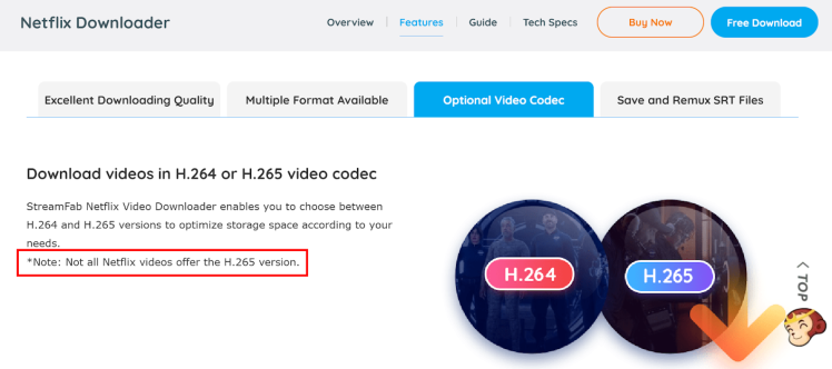

                    I did go to look at what StreamFab markets regarding the capabilities of their Netflix Downloader..... and they do in fact state that "Not all Netflix videos offer the H.265 version."..... although most rational people would interpret that as the exception to the norm..... not THE norm.....
                    I attached a screenshot of their marketing image..... I highlighted the referenced caveat in red.....

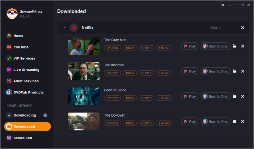

                          So, like i said before, non-Netflix originals will not be in H265. I don't really have the time this weekend to check if they are Netflix movies but i can see the majority are NOT Netflix movies.
                          There is, however, an issue with these 3 movies. I know for a fact that they are Netflix movies and i have downloaded them before in H265.
                          Just fired up v6.1.4.4 and tried to download them. They are coming in as H265 HDR.
                          Click image for larger version  Name:	image.png Views:	1 Size:	142.1 KB ID:	431005
                          A few versions ago, i was getting NO H265 AT ALL on one of my downloading PCs while 2 others were getting H265 with the same titles.
                          I don't know if it was the fact that i had several x64 versions that had certain settings that only existed in newer versions but my troubleshooting mind told me that must be the issue. That's because the other 2 PCs had multiple versions but all very close to each other and didn't have missing settings.
                          I proceeded to uninstall all versions, deleted all DVDFab folders, and did a search and delete in the registry for all references to DVDFab (I only own StreamFab).
                          I then installed the latest version and i got H265 again in Netflix.
                          It didn't "fix" old stuff that should have H265 but it did "fix" the newer and ongoing stuff.
                          Maybe you guys can try that and see if that fixes your issues.
                          Any Netflix TV Show that hasn't ended and any Netflix movie should download in H265 HDR. H265 SDR seems to be completely broken and older TV Shows that have ended have no H265 at all.
                          Perfect example of a Netflix TV Show that doesn't have H265 but used to is the German language Dark (great show BTW). For Netflix movies, The Do-Over is from 2016 and it does download in H265 HDR so that is why i am saying all Netflix movies should in theory download in H265 but the majority of your list are not Netflix movies besides the 3 i quoted and You People.
                          So, again, if there is no red Netflix logo on the TV Show/Movie thumbnail, it will not have H265. This is "normal" behaviour.
