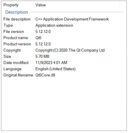

                I think you found the culprit in OneDrive but I'm concerned that your qt5core isn't showing 5.12.12.0 like mine does and what your error says. The (version 0x50c0c) in your error is 5.12.12.0. I almost had to look it up on my IBM 360 Green Card. Only another old-timer geek would know what I'm talking about. Ahhh, EBCDIC and Hex, those were the days.
                Note: I haven't installed 6.1.5.0 yet so maybe they backed off on the Qt version? I haven't personally modified anything having to do with Qt so even the date matches the 6.1.4.9 release.
Name:	Screenshot 2023-11-15 4.02.11 PM.png
