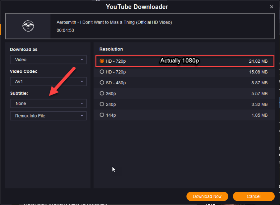

      As i have explained in another thread, the logic for the formatted resolution is completely wrong. That is why they should display the actual resolution (1920x916) instead of the formatted 1080p/720p/576p/480p/360p stuff.
      StreamFab does detect the 1080p AV1 but it tells you it is 720p:

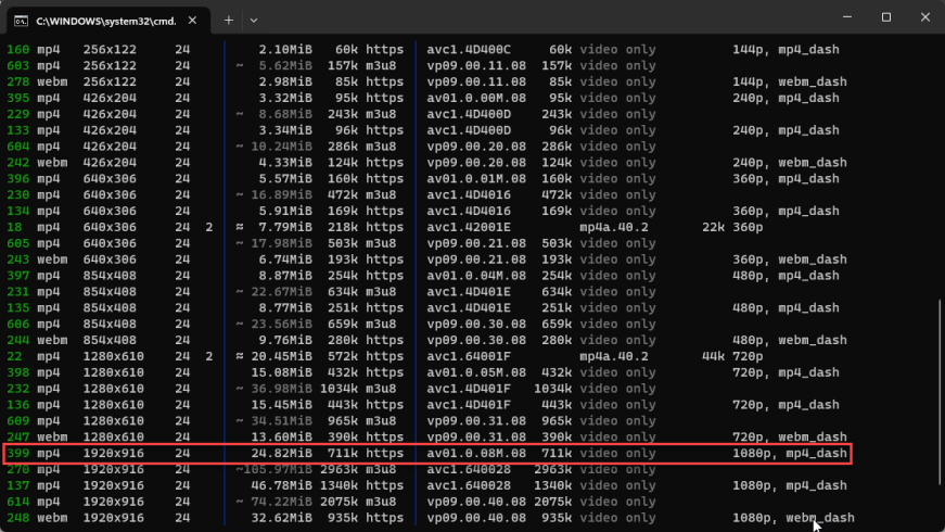

      ​My suggestion for you until StreamFab fixes this would be to download yt-dlp and use it to list which formats are available so you can compare the sizes with what StreamFab shows you.
      That way you can select the right one. The yt-dlp command i use is:
      Code:
      yt-dlp.exe -U -F --no-geo-bypass --cookies-from-browser edge "%url%"
      This is used in a batch file so that is why the URL is a variable so adjust it to how you will run it. Obviously if your browser is Chrome or Firefox, adjust that too.
      So when using
      Code:
      yt-dlp.exe -U -F --no-geo-bypass --cookies-from-browser edge https://www.youtube.com/watch?v=JkK8g6FMEXE
      , this is what you get:

        Thanks for the response. I must have missed the part of using the other program to verify what is there, but it is certainly a good idea with the current state of the downloader. I did find a second video that showed up FHD and of better quality, but the encoder didn't crop the black bars because of the burned in subs when the movie parts are talking. Essentially what you are saying is SD looks at vertical resolution and tries to match it to something close, in a downward direction. Any idea what the threshold is for 2160p before it reports 1080p? Is it literally 2159?
