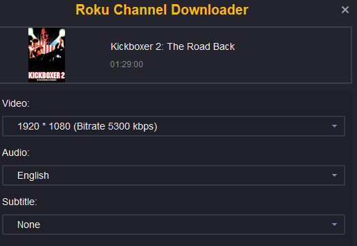

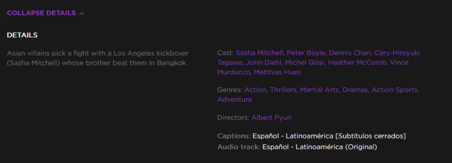

    I'm noticing (a lot more now than before) that Roku is streaming films that are dubbed in another language and is indicated as such on their website; however, when SF analyzes the stream it is (almost?) always showing the language is English.
    Example: Kickboxer 2 - The Road Back (link attached)
    This has been happening for a while with very specific titles and I've been ignoring the problem (and trying to find the titles elsewhere) but today I decided to find out if the Roku website is showing that it would be played in English but SF is downloading it in a different language. Turns out the langauge being downloaded is correct, but the "Roku Channel Downloader" widow that pops up when you choose a title is showing English.

    That is very bizzarre...
    If you look in the MPD file, the audio clearly says spanish:
    Code:
        <AdaptationSet mimeType="audio/mp4" segmentAlignment="0" lang="es-MX">
          <Label>Español - Latinoamérica (Original)</Label>
          <Representation id="10" bandwidth="128000" audioSamplingRate="48000" codecs="mp4a.40.5">
            <AudioChannelConfiguration schemeIdUri="urn:mpeg:dash:23003:3:audio_channel_configuration:2011" value="2"></AudioChannelConfiguration>​
    It also says no subtitles but there are English WebVTT Closed Captions too. Weirdly enough, the naming of the .vtt file would suggest that the CC are also in Spanish:
    Code:
    LG_KICKBOXER2_F_HD_2CH_EN_Lionsgate_20220603T232945_cc_es-mx.vtt
      We will check as soon as possible.
        It‘s been fixed, please keep an eye on the coming version this week and try again, thank you.
