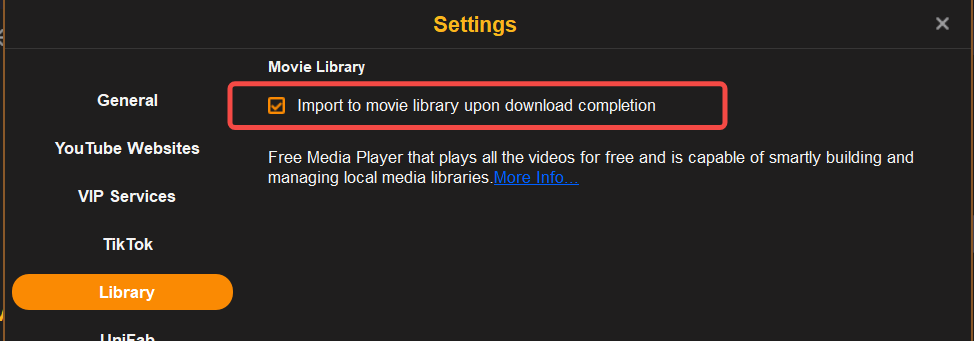

              JBohananJr, what settings? Where? I am not finding "Import to Movie Library" in my StreamFab Settings.
                click on "LIBRARY" the setting 'Import to Movie Library upon download completion' is inside there.
                  Please check the image attached. Thank you.
