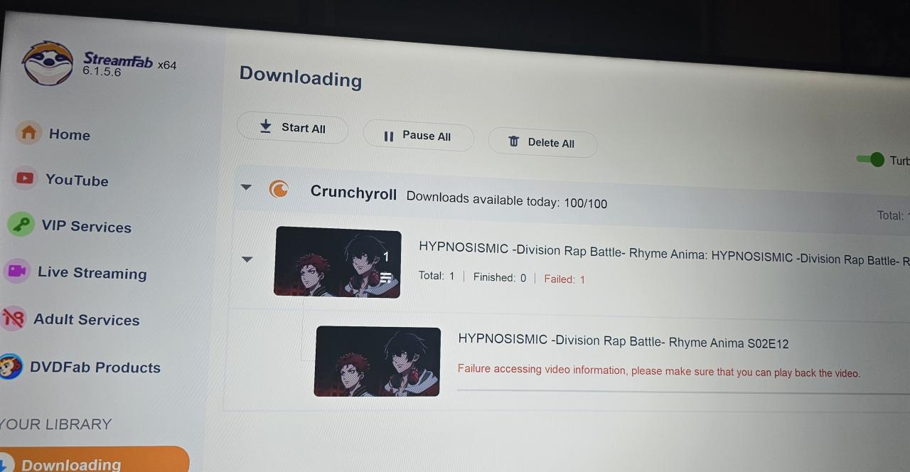

    I just tried to download on version 6.1.5.6 and I still get the same results.
      #17
      The version 6.1.5.6 had been released but the CR problem is still not solved.
