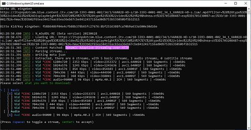

        ITVx offer subs in browser - but no info about this in Manifest (mpd),
        so no subs listed i.e. with N_m3u8DL-RE
        Click image for larger version  Name:	itv_mpd_nosubs.jpg Views:	1 Size:	262.3 KB ID:	434568

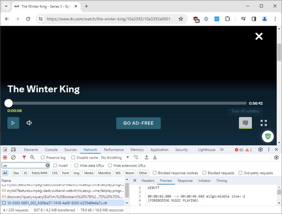

        In Browser Dev Tools i can filter: vtt and can see/open/dl the subs:
        Click image for larger version  Name:	itvx_browser.jpg Views:	1 Size:	71.1 KB ID:	434569

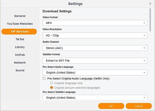

        StreamFab v6.1.5.5, Windows 10 Pro x64 up2date
        UK via ControlD (UK via VPN the same) | both getting subs with SF 6.1.5.4

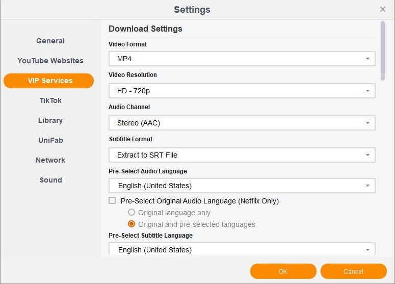

        VIP Settings: mp4, 720p, aac, srt, in this case changed language to english:
        Click image for larger version  Name:	sf_settings.jpg Views:	1 Size:	73.1 KB ID:	434571

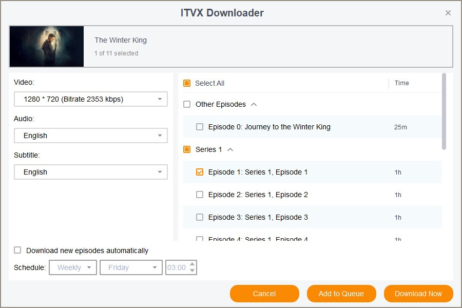

        ITVX Downloader:
        Click image for larger version  Name:	itvx_selection.jpg Views:	1 Size:	87.8 KB ID:	434570
        Result: mp4, 720p, aac, no srt, english

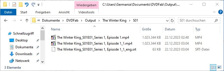

        Same pc, connection, temp + settings with V6.1.5.4 and i have srt in output:​
        Click image for larger version  Name:	itvx_result.jpg Views:	1 Size:	58.7 KB ID:	434572
