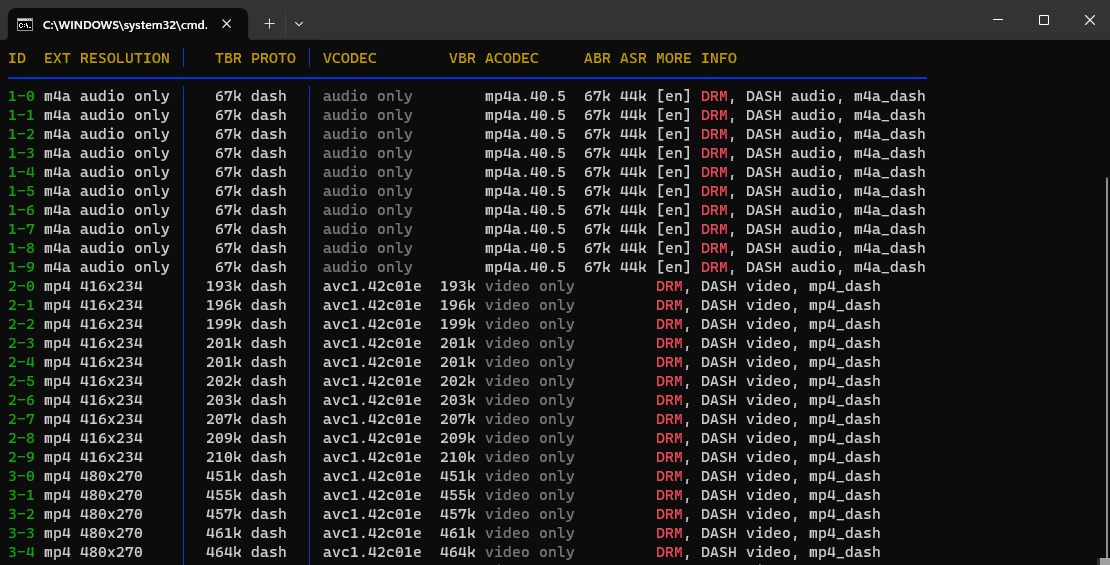

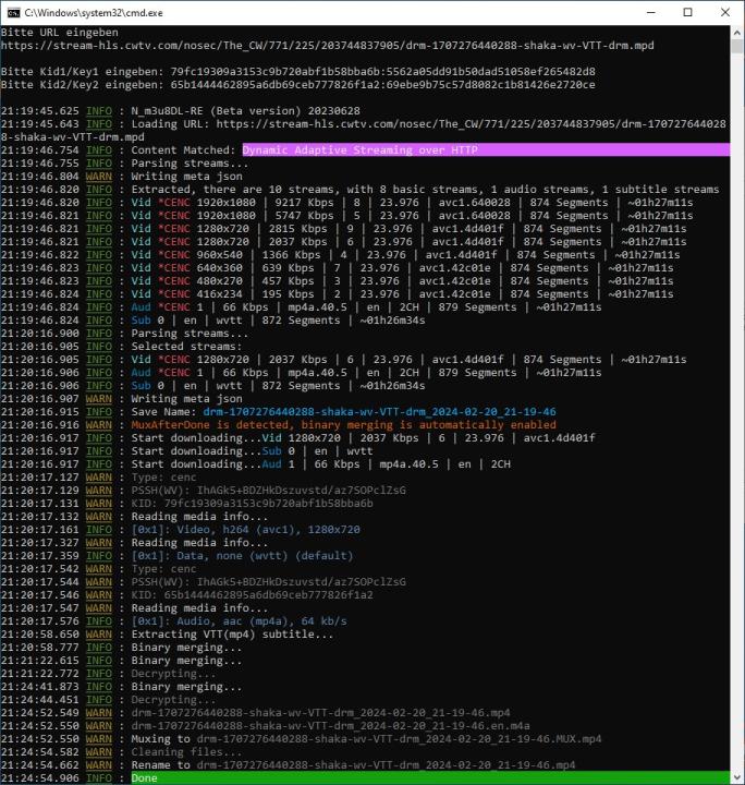

        What version of yt-dlp is this? My 2023.12.30 version doesn't support TheCW.

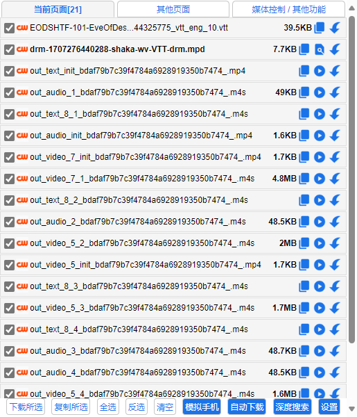

        And if i use the MPD, i do see the separate Audio streams:
        Even cat catch sees the separate audio...

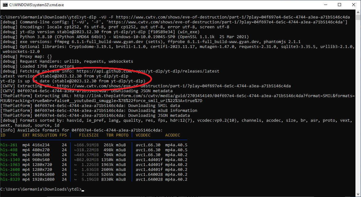

            What version of yt-dlp is this? My 2023.12.30 version doesn't support TheCW.​

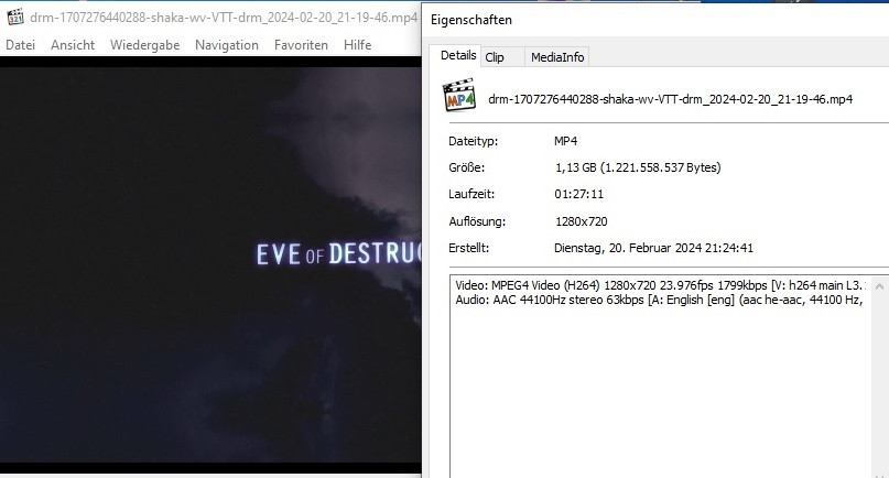

            Here we are:
            Click image for larger version  Name:	cw_eve_of_descruction_dl.jpg Views:	1 Size:	116.1 KB ID:	437878
            Result:
            Click image for larger version  Name:	cw_eve_of_descruction_result.jpg Views:	1 Size:	61.1 KB ID:	437879​​
