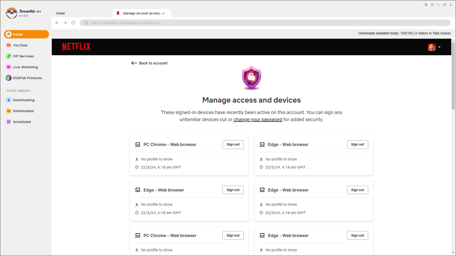

  • ejm
    replied
    When using any of my devices including streamfab, uder settings in netflix show them as being Edge.
    I went back to version 6.1.6.7 and tried to D/L the same movie that I previously downloaded on netflix and was unable to download it.
    uploading photo as well

  • Cats4U
    replied
    Originally posted by ejm View Post
    after doing some investigations I noticed that steamfab uses edge as it's interface, so that is why you can't download at the moment.
    No, no, no. StreamFab does not use Edge. They use CEF (Chromium Embedded Framework). As the name suggests, it is a variant of the Chromium browser that can be embedded in other applications. What you are seeing is what has been set up as its User Agent. Websites check browsers that connect to them to see what type of browsers are being used. It is believed by some that streamers track suspicious browser types and sometimes block them. StreamFab and many other programs of questionable purposes use a technique known as User Agent Spoofing. They will occasionally spoof their appearance to the streamers such as browser type, OS type, and OS version to confuse the streamer. The next update of StreamFab it could possibly look like you are using a Firefox browser, version 118, on a Linux computer. Two years ago, I requested that the user be given the ability to change the User Agent to whatever we want. I'm still waiting.
