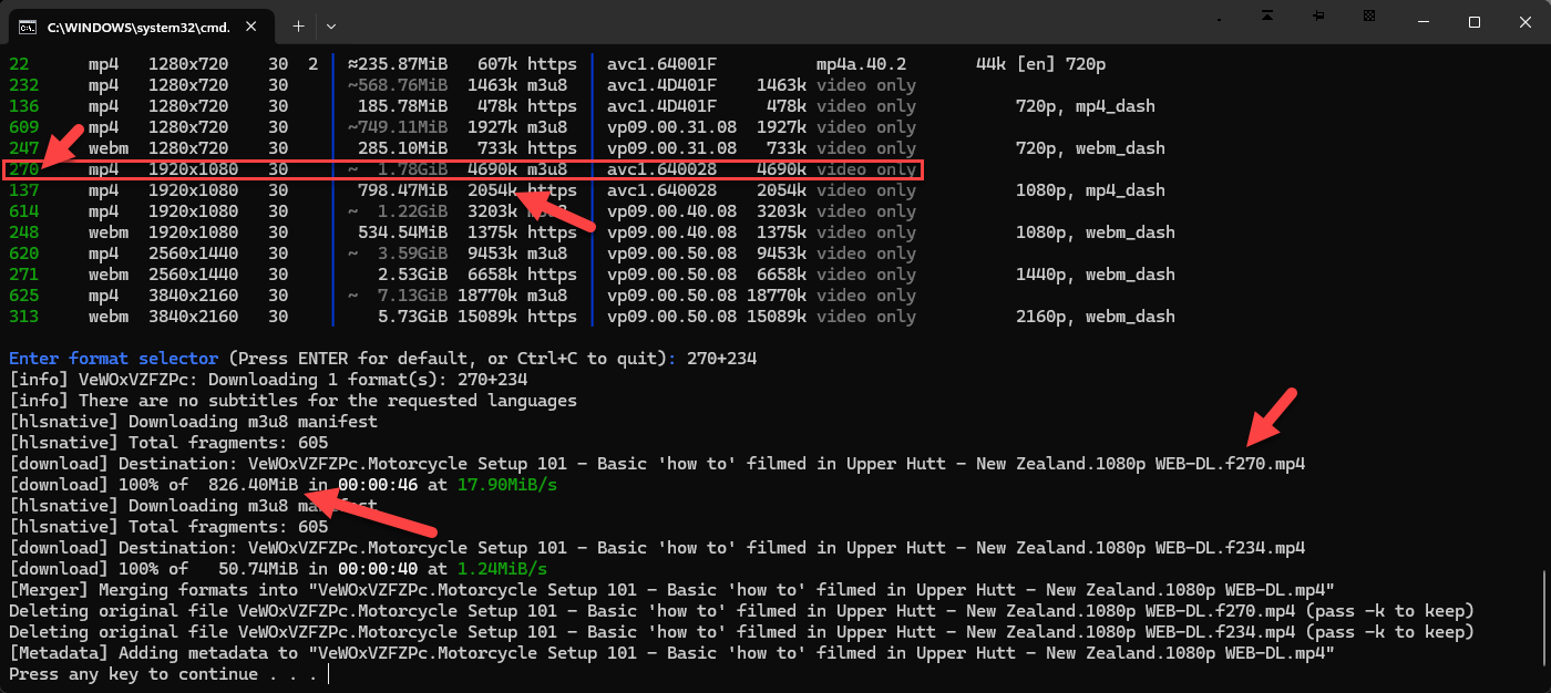

    It's a different streaming protocol.
    The larger one is a bunch of chunks inside an m3u8 playlist and is using HLS streaming. The size displayed is a guesstimate and it usually is way off. I think it's because of the bitrate it thinks the video is using.. The https streaming is usually bang on for the size as the reported bitrate is accurate.
    If you look at the results of yt-dlp's format list, the size is in grey and the ~ precedes the size to show it is "approximate". Not really approximate but basically all resolutions will have an m3u8 version and an https version but on the backend, it's the exact same video. So when you see there are only 2 options per resolution/codec/format, the lower size is what you will get no matter what you select.

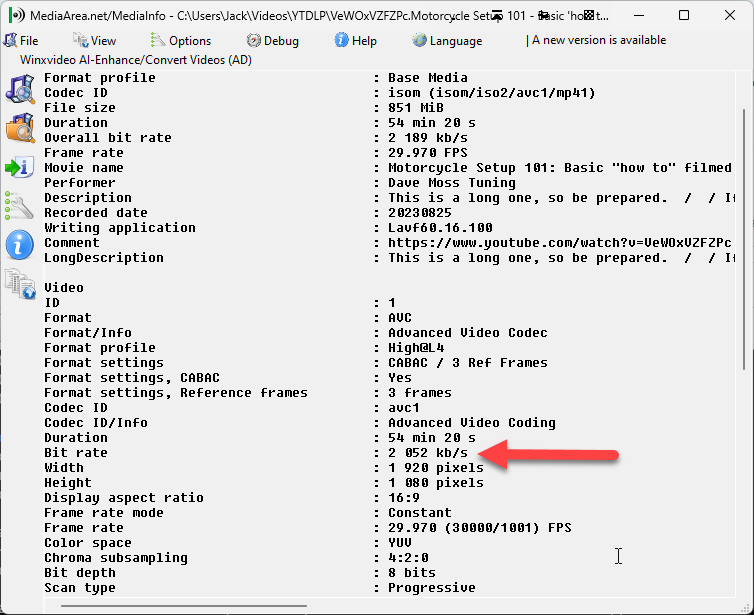

    Here are some screenshots showing what is happening:
