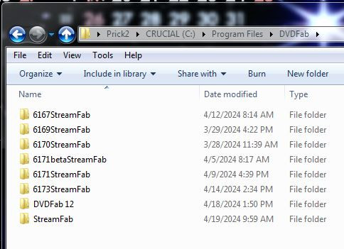

              As you can see I've been fighting with it for a while. Current version being tested is 6.1.7.4. And yes, that IS my machine's name as I've often been called a prick. My file and print server is Shithead (been called that too). I must be doing something right.
