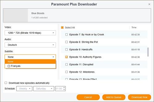

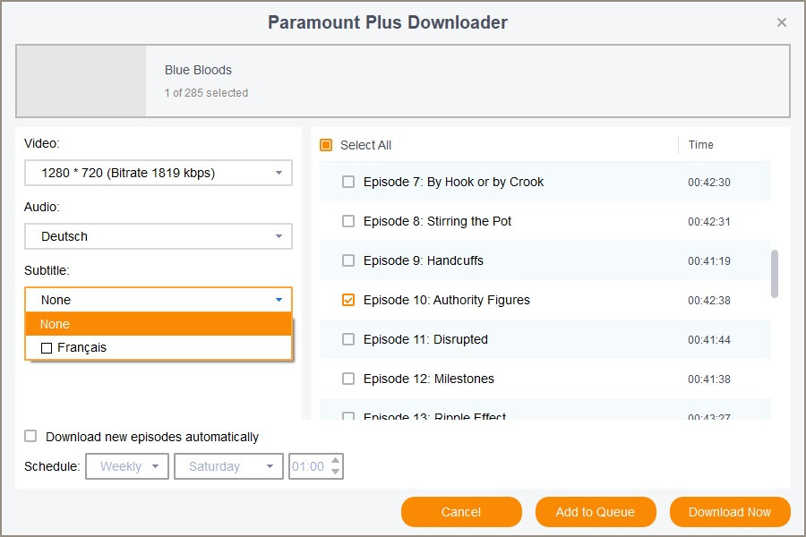

    Blue Bloods S09E10 is another example of English subs available but SF sees only French.
      I can only confirm it for Blue Bloods.s09e10 @ Paramount+ USA
      Only fr subs in SF offered

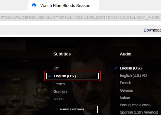

      and in Player: en,fr,de,it (en is AD - )
