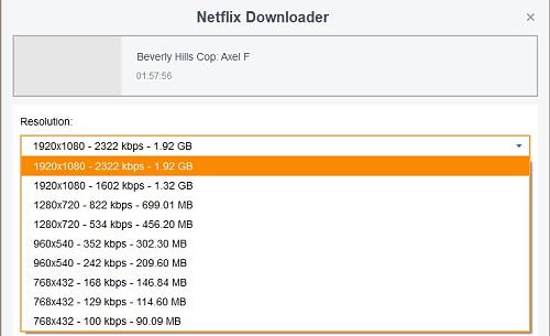

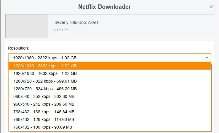

                    So I went to 6188 and i still dont see the higher version of the file for axel F and i know it exists i do have two profiles one that is 2322k and one for 1600k any thoughts? I just did a full uninstall and deleted the streamfab folder in the documents folder re-installed with the offline installer.
                      This is x264 High Profile:

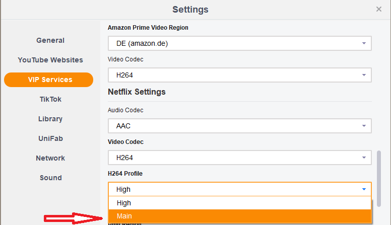

                      Open the "Hamburger Menu" (3 lines top right) select Settings
                      - click left on VIP Services
                      - right under "Netflix Settings" you must
                      - change "H264 Profile" from "High" to "Main"
                      - click ok and try again

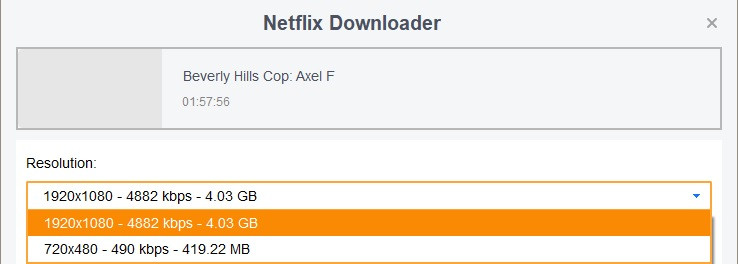

                      et voila
