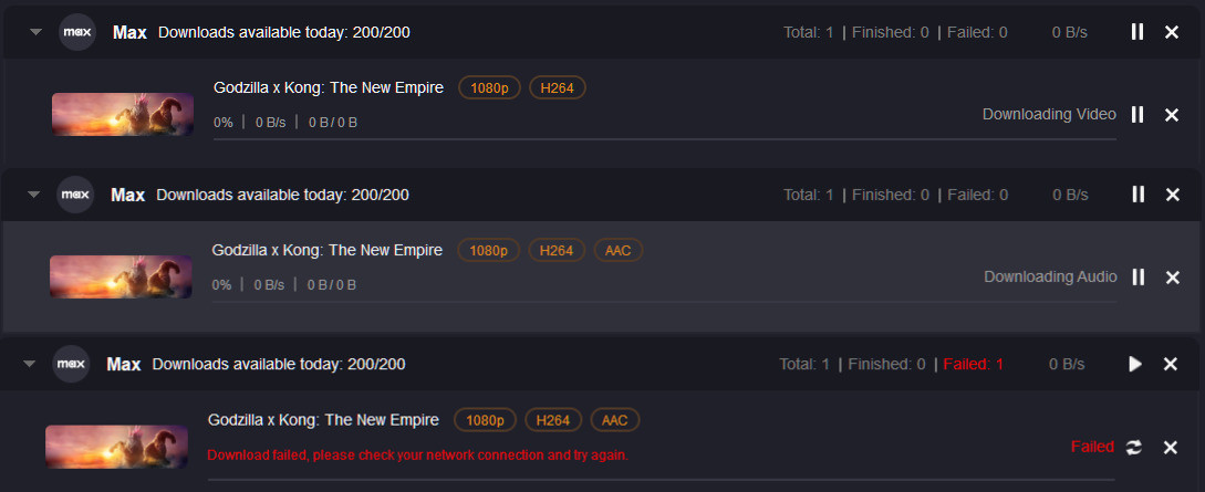

        Wilson.Wang If you need another one, here's my Max downloads log showing today's failures in the U.S.
        StreamFab.log
          #34
          [ATTACH]n447161[/ATTACH]

          From the log file, it's failed directly when downloading the stream video file from Max servier.
          Let's check the network connection first.

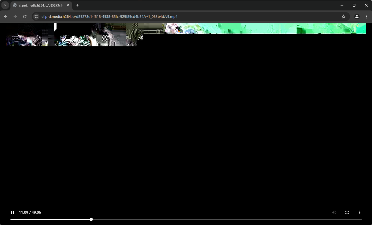

          - Open the video url "https://cf.prd.media.h264.io/d85273c1-f618-4538-85fc-929f89cd4b54/v/1_083b4d/v9.mp4​" in your Chrome browser, make sure that the encrypted video can be played back in Chrome (see the attached pic)
