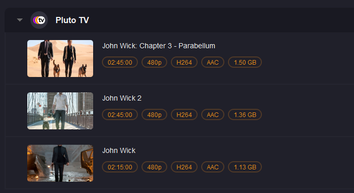

      3 movies just downloaded from Pluto.

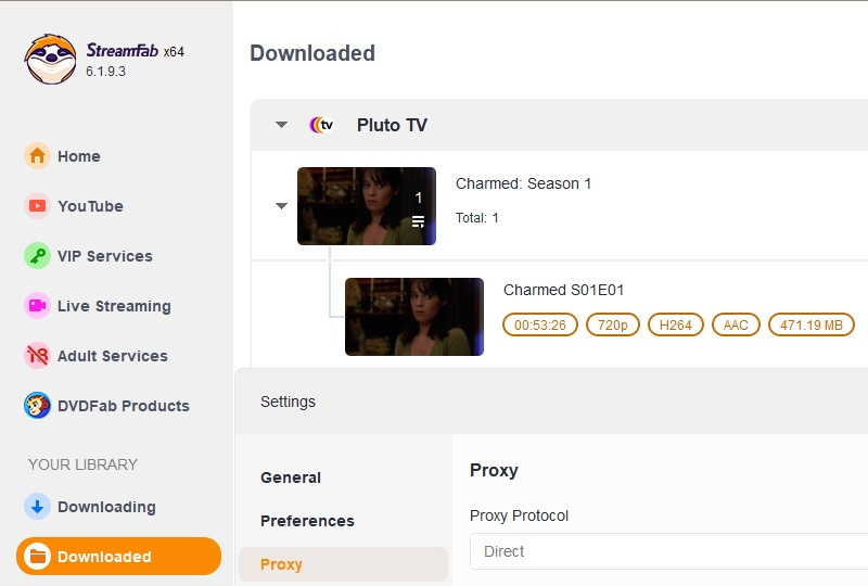

            I just tested Charmed.s01e01 via Norway ..
            I assume you have in StreamFab.log multiples
            Code:
            [Critical]: QtDownloadTask::onError : errorString :Host siloh-ns1.plutotv.net not found, code : 3
            Then open Settings => Proxy and change from SOCKS4 to Direct
            This is a bug (only) after Upgrade from SF 618x to SF 619x - see here
            Click image for larger version  Name:	pluto_no_charmed.s01e01_failed.jpg Views:	0 Size:	99.3 KB ID:	447956
            Click image for larger version  Name:	pluto_no_charmed.s01e01_okay.jpg Views:	0 Size:	69.3 KB ID:	447957
            -= click pic to enlarge =-
            If, contrary to expectations, this does not work, then here
            btw: If you need Netflix AV1 change back to SOCKS4​

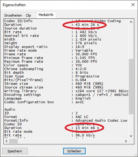

              Change Proxy to Direct did the trick.....but there is no audio after 13min 46sec in the downloaded video...
                No sound after cut-out ad-break
                Sorry about, but SF can't currently - the audio ended at ad-break:

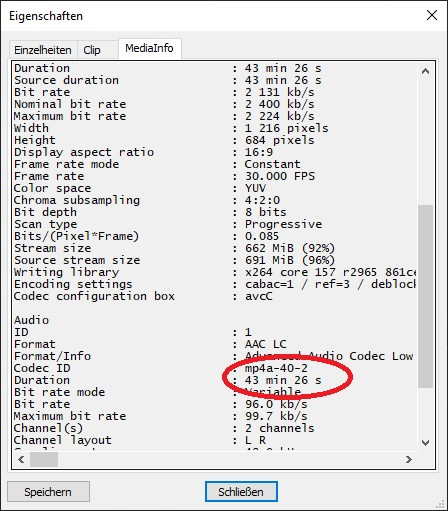

                The multiparts protected DRM need Keys to decrypt ..
                .. it's to heavy for people without experience in this area
                But you can dl the unprotected video (ad-free) with yt-dlp or N_m3u8DL-RE
                Code:
                yt-dlp "http://silo-hybrik.pluto.tv.s3.amazonaws.com/462_pluto/clip/667eab72fe060c00132467fa_Charmed_Something_Wicca_This_Way_Comes_Pilot_S1E1/720pDRM/20240628_052418/hls/0-end/hls_2400.m3u8"

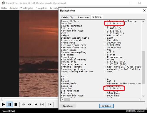

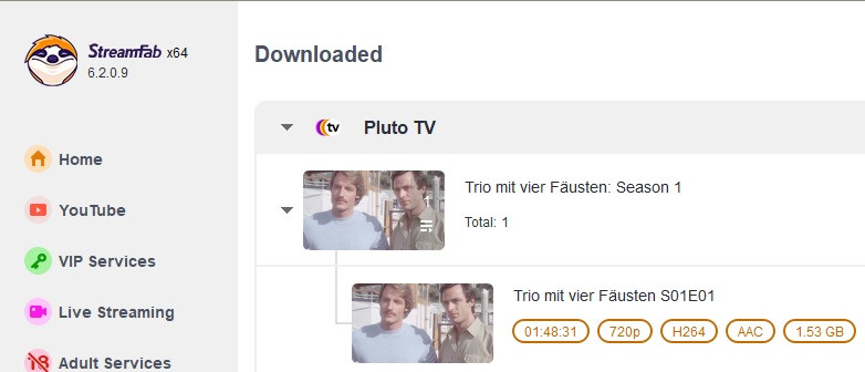

                        I tried "Trio mit vier Fäusten.s01e01" in Germany and have no problem

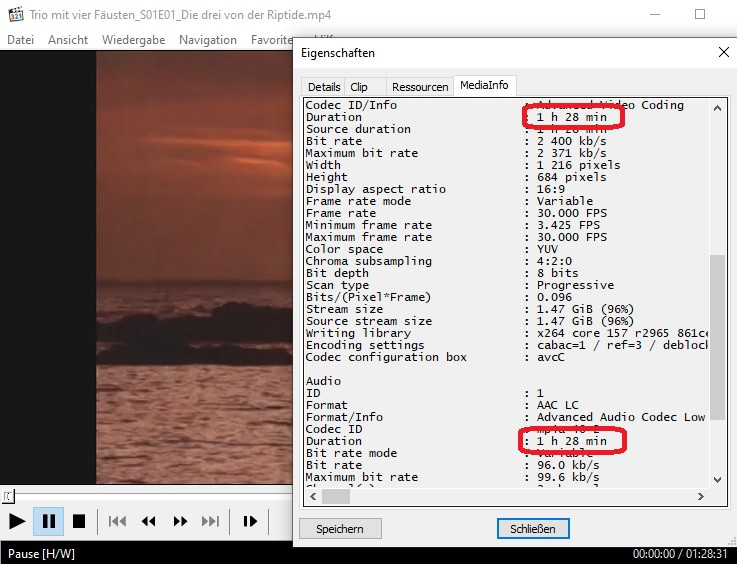

                        and yes full audio length:
                        The Audio problem was fixed by using drm free m3u8
                        instead multipart protected mpd (so no FHD) - see also here
