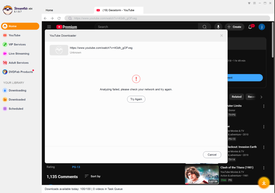

        Tried fresh install of 6197 and changed my dns to 8.8.8.8. Still a no go.Click image for larger version

            Tried fresh install of 6197 and changed my dns to 8.8.8.8. Still a no go.Click image for larger version  Name:	image.png Views:	0 Size:	111.7 KB ID:	449788

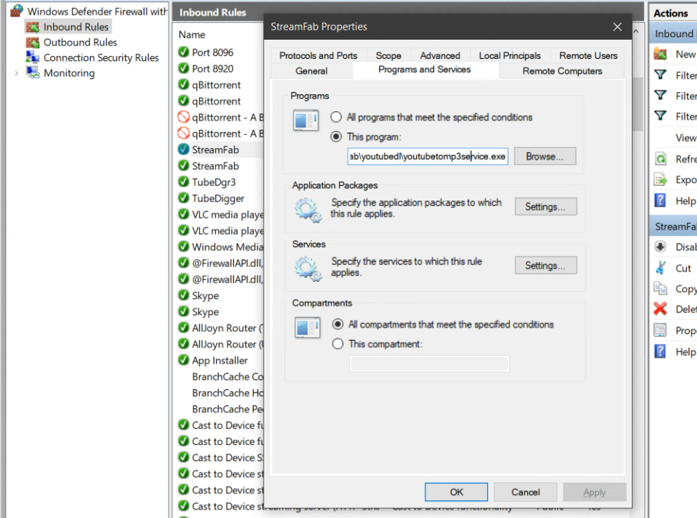

                As mentioned previously, this could be a firewall issue. You say you "disabled" the firewall. What you should be doing is making sure that the inbound firewall rule for YouTubeToMP3Service.exe listed under the two StreamFab entries are enabled. Also, make sure that the YouTubeToMP3Service.exe is listed in your Services as either Automatic or Running.
Name:	Screenshot 2024-09-06 7.50.59 PM.png

                    Cats4U: I was able to create/add the inbound firewall rules for youtubetomp3services.exe and enabled them. I don't see the youtubetomp3service.exe listed in my services at all. Can I add it and if so how do I do that? Again, thank you for your help.
