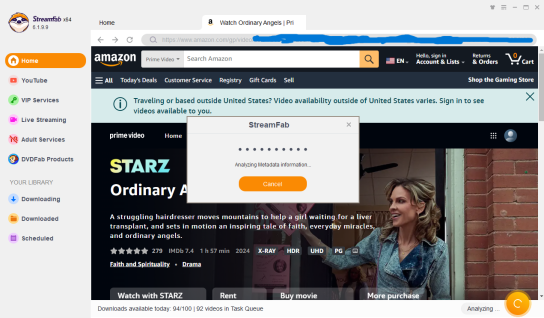

                      My main-page after my first download btw. looks like this. Don't mind StreamFab analyzing, that just happened when I opened Snipping Tool to take the screenshot for some reason.
