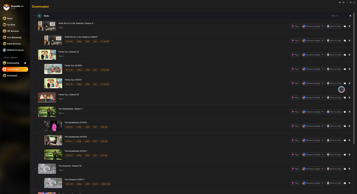

                          Sorry for this to trouble to you.
                          Firstly, I can confirm that H264/H265 1080p and 4K videos can be downloaded with Hulu Basic plan. (Subscript Hulu directly from hulu.com)
                          But, I'm not sure that why the H265 videos can not be downloaded with the Disney+ Hulu Bundle Trio Premium subsciption. H264 video can be downloaded only.
                          The stream mpd file can not be downloaded.
                          "message": "DMS-404-001: Unable to build DASH switching sets, invalid presentation: missing video switching sets"
                          Anyway, I will ask the dev to check it.
