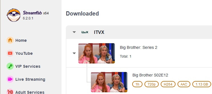

    My Download looks okay:

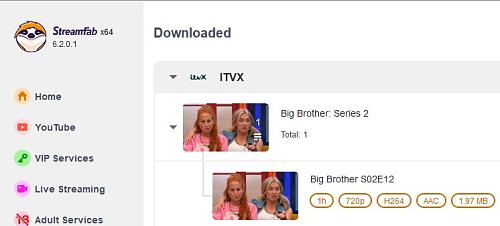

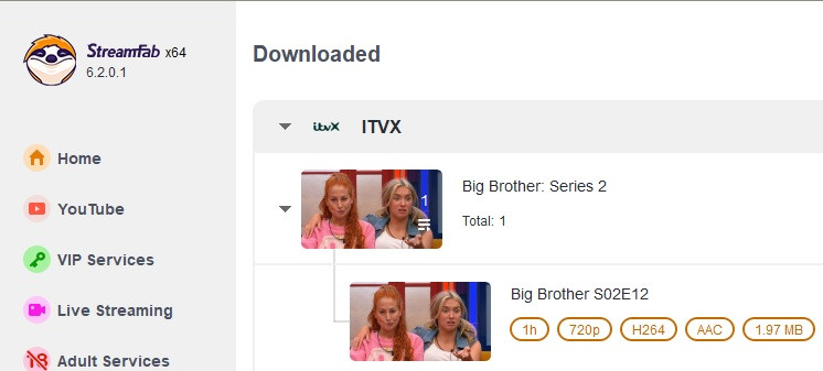

    But the not selected (!) subtitle make the remuxing fail.
    My result is only 2MB - of course without error info in SF
      Looks like the "CW effect" - info
      I need to select (unwanted) subs for errorfree remux​

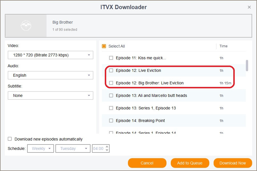

          I could now say that it is possibly due to the two s02e12 episodes ..
          .. but I can't detect any problem - neither with analysis nor during playback.

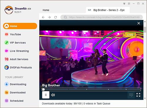

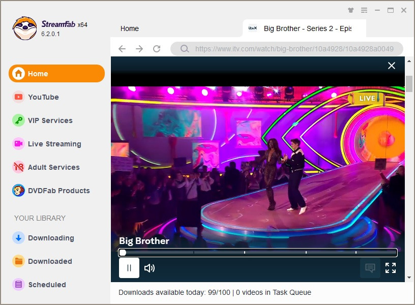

          > When trying to play through a browser, I get Something went wrong.
          Can you play the episode in your regular browser?​
            Everything worked today - with no changes from yesterday. Weird. Thanks for your willingness to help. This can be closed.
