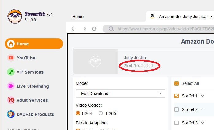

Latest streamfab 6.2.0.2 only seems to show the first 25 episodes of a season,
This topic has been answered.
    #16

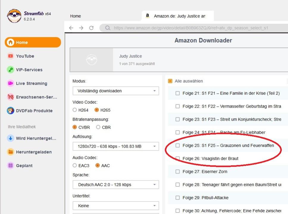

    I don't think it's so easy ..
    Open a website (season 1) with > 25 episodes in your regular browser
    Open "view page source" and you will find S1 F25 - but no S1 F26 !
    (even if you scroll down first to see more than 25)​
    shouldn't be that bad, worst case: you fake a getD_____W______ call with the correct token and that returns you a JSONised list of episodes that weren't on the page so far...

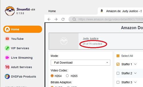

      #18
      In the streamfab_x64_6198.exe version it works fine choosing more than 25 episodes.
        #19
        no comment
          #20

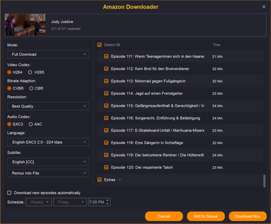

          A few days ago it was working fine, I downloaded a series of more than 300 episodes, but I updated to the new version of streamfab and then I wanted to try the version I mentioned and it no longer works, it only selects 25 episodes.

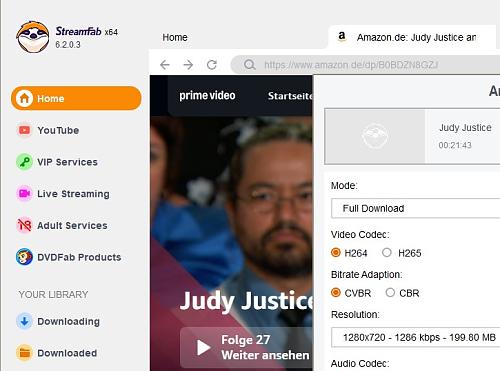

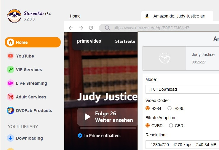

              After I received a request via PM in this regard ..
              It is possible to download unlisted Episodes in "Movie Mode".
              You need to start the episode before analysis ("Continue watching")
              and you must disable 4 lines in \script\amazon_get_seasons_info.py - see here
              But unfortunately only each episode can be dl individually (not several in queue)
              and the result have no season or episodes number

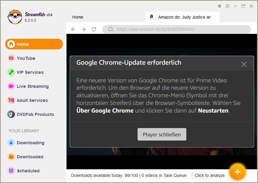

              Unfortunately, things have become a bit more complicated at the moment ..
              .. because I can no longer play Amazon in 6203 ("Google Chrome-Update required")
              Therefore, the desired episode must first be started in the regular browser.

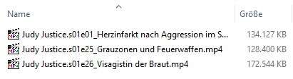

              -= click pic to enlarge =-​
                #23
                What is that all about? I can play videos from Amazon.com and PrimeVideo.com no problem in 6.2.0.3...
                Click image for larger version  Name:	image.png Views:	0 Size:	981.6 KB ID:	452831
                  #24
                  No change on my side - yesterday it works without issues:
                    #25
                    Strange, I haven’t received that message yet.
                      #26

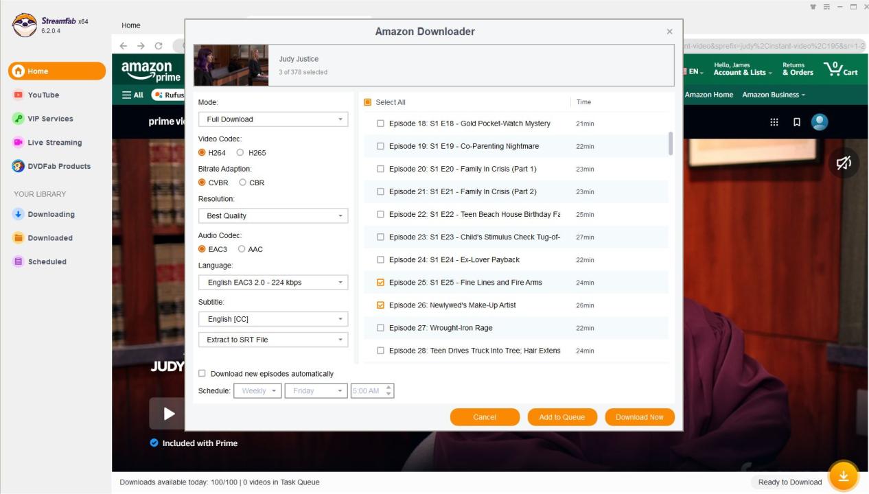

                        #27
                        Please try the test version for the Amazon 25 episodes problem.
                        I could select and dl more than 25 episodes - great ..
                        .. from episode 26 the episode number is missing in the download
                        But my resulting filenames are okay !!

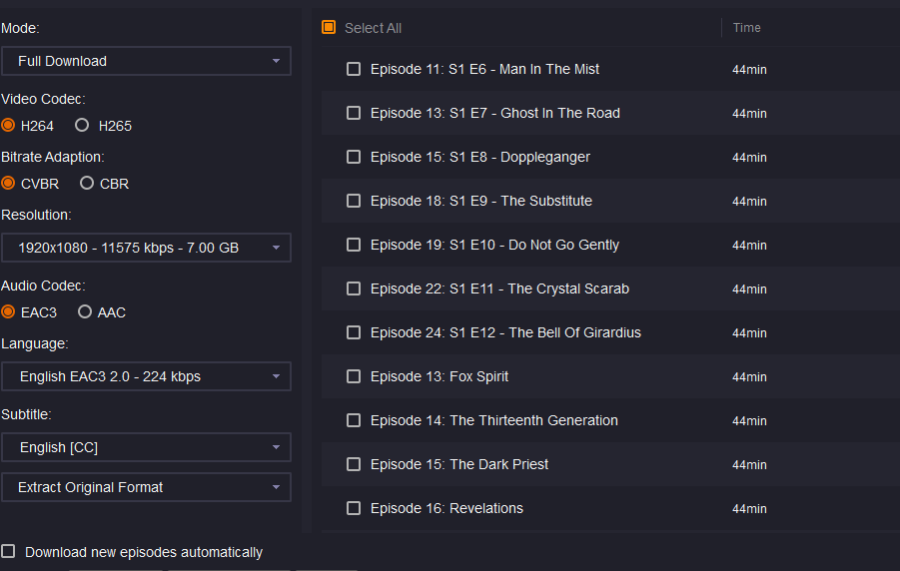

                          #28
                          Click image for larger version  Name:	1.jpg Views:	0 Size:	95.0 KB ID:	453361 Same on U.S. Amzn.
                          After Ep 25, missing season/episode number (Sn En) but the resulting filenames are ok.
                          Click image for larger version  Name:	3.jpg Views:	0 Size:	39.5 KB ID:	453362
