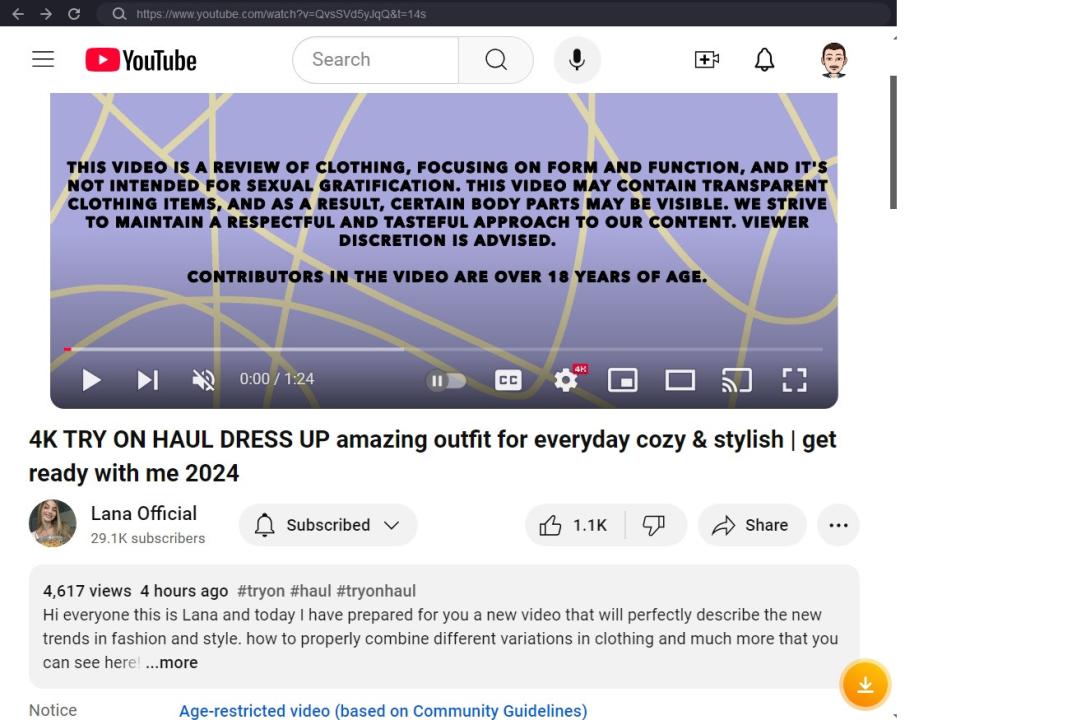

Something wrong with downloading video streams on Youtube with StreamFab. Now I see listed under video description... Age-restricted video (based on Community Guidelines) I have Restrictive Mode... OFF. Video does Play on my computer just won't downwload
Last edited by JohnnyJT; 12-08-2024, 10:24 PM. Reason: Added... Video does Play on my computer just won't downwload
if your signed in to youtube, then you should be able to download age-gated material.Originally posted by JohnnyJT View PostSomething wrong with downloading video streams on Youtube with StreamFab. Now I see listed under video description... Age-restricted video (based on Community Guidelines) I have Restrictive Mode... OFF. Video does Play on my computer just won't downwload
