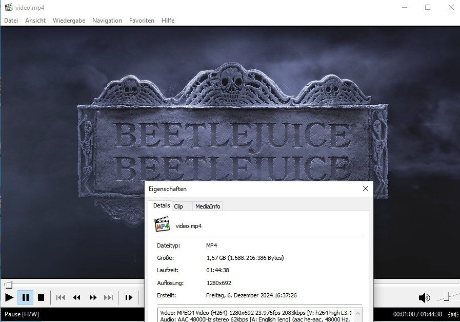

            I could dl/decrypt "Beetlejuice Beetlejuice" with 1280x692
            vid hd here
            decrypted with:
            Code:
            0102591be053bc77ebf6ccb8a156360e:57aa491ee36db541871fce611e8f5010
