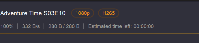

    For quite some time now, the Max module (for USA transfers) seems to have a mind of its own in regards to which files are going to download at "regular" speeds and which ones are going to download at "byte" speeds. Not kilobyte...byte.
    It seems like if I've got a list of TV show episodes in the queue, every third or fourth title downloads incredibly slow. Sometimes those downloads will ultimately fail.
    I'll give an example: Before I left work I started downloading. When I came back, only 20 episodes completed successfully, and 9 had failed (and the last of the 9 is still trying to complete as I type this). Each episode is around 12 minutes long. So while I was gone 10+ hours, it successfully downloaded 20 12-minute episodes.

Name:	2025-04-07 16_45_47-StreamFab.png
    (This is just a sample of what I'm seeing. I've been home a half hour now and progress hasn't moved.)
