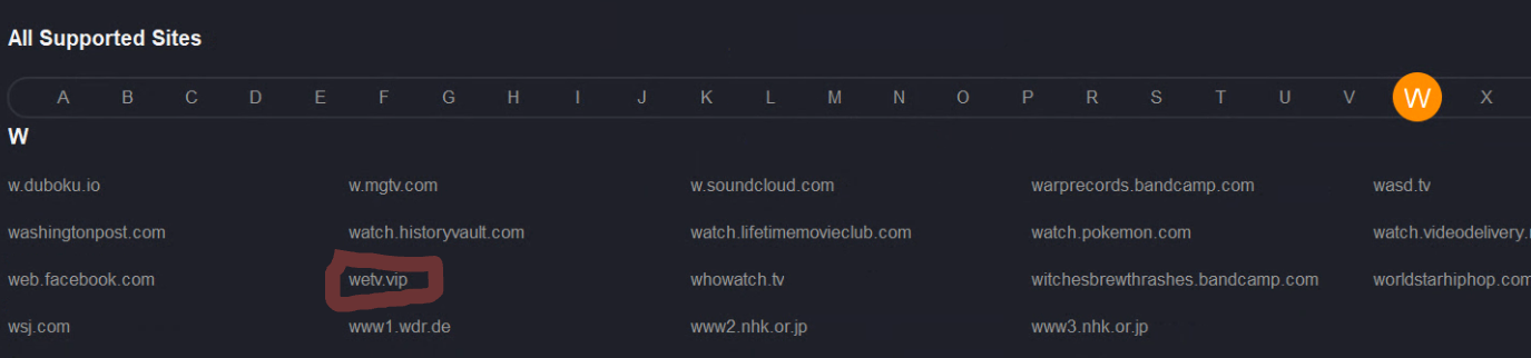

                    As far as I know, wetv.vip is not an SF VIP module. Do you have another name for the module as an SF VIP? I am not well versed in Chinese streamers. It can be found listed under the YouTube listing.
Name:	Screenshot 2025-05-07 3.38.24 PM.png
                    Except for the free gay boy shit, the few pay videos I looked at appeared to be DRM M3U8 and that's how I labeled them. Getting back to the title subject, I wasn't able to bring up subtitles in MKV (FFmpeg) either.
