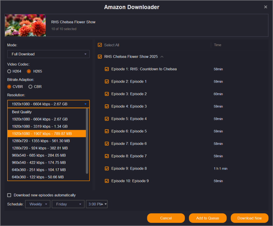

    Trying to download RHS Chelsea 2025 from Amazon/Britbox. Quality SF offers after analyzing for 1080p x265 are Hi, Med, Lo bitrates. First 3 days the chosen Lo bitrate files downloaded fine at ~ 900kb. Last 2 days SF downloads the Hi bitrate 4GB files, no matter what I set. I do not get any flag that chosen quality may not be available.

          Since I don't know the episodes giving you a problem, I bought a subscription on Amazon Canada and downloaded season 5 in its entirety.
          I selected this:
          The results were:
          As you can see, all downloaded fine except the last one. The Last one is H264 instead of H265 and, it's the top bitrate.

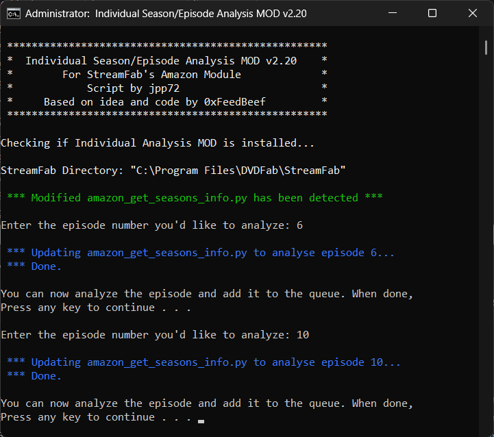

          I then used my mod to select episode 10. Notice that i run the script once and just keep feeding it new episode numbers to scan. You can leave it running and don't have to close it, so your comment on it being too much of a hassle has been answered.

          After telling it to analyze episode 10 and clicking the analysis button, episode 10 is selected and defaults to H264 because H265 is not available.

          So this is not a StreamFab issue but an Amazon issue. Amazon will very often quickly upload the H264 version of a new episode and then add the H265 version later during the day or sometimes a few days later. Sometimes, they forget to add the H265 at all. Very frustrating for people who are anal about consistency of their collection (like me) but hey, nothing we can do about that.

            Tried "Season/Episode" mod before - followed steps - SF running, Amazon open to desired series, ran .cmd as admin, confirmed privilege - nothing happened - no additional Mod window - just back to underlying SF window. Tried again now with latest Mod v6.2.3.2+ - same results. Can't be sure, as the Mod does run, but seems it would have to be run every time? That is too great a hassle if true.
            Where exactly does it say you will get a new mod window in the mod's description? I seem to see a lot of this on many forums where people skim through explanations or just don't understand what is written.
            I am pretty sure that it's abundantly clear in that thread that all it does is force StreamFab to analyze an episode of your choosing. That episode will then show up at the top of the list in the native StreamFab interface, as shown in the last screenshot of my previous message.
