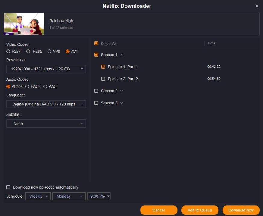

          Is the program choking because of the audio setting​ as october262 suggests? A previous h264 copy has eac3 2.0 audio so why it's not an option now.
          And my preselect window also shows a much larger size (I am pretty sure that is the h264 file size).

            Looking at post 19 as october262 suggests, audio data is already mjg.

                    Please try to change VIP Setting - Netflix Audio Codec form Atmos to AAC before analyzing

                      Tried NCIS and also getting the download window with AV1 preselected, a file size and bitrate, but when I download, it takes a very long time and eventually just does h264.
                      New log available if need be. I am now running the latest 6247.
