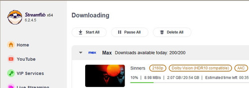

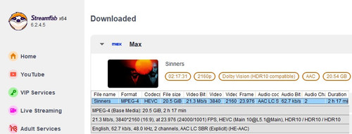

        I did get it to work at 1080p using h.265 SDR. Seems the problem is only using HDR, 1080p and 4k resolutions. I did not try DV as my TV doesn't support it.
          Using Dolby Vision does successfully download even 4K.

                  Sinners works fine for me using H265
                    In 4k HDR10 ?
                    I tried over ten times with different SF versions in different countries - the DL never started​ ..
                      Same issue with Batman Ninja vs Yakuza League. Submitted a ticket.
                        Try the new version, it works for me!
