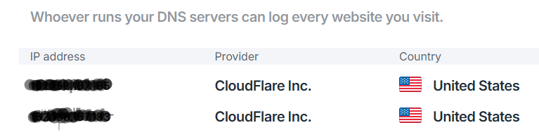

Try sites like or other DNS check sites.
Code:https://surfshark.com/dns-leak-test or https://ipleak.net/

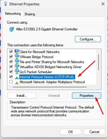

ADDED NOTE: I don't even nor can change my DNS in the modem/router, you can change it in the network device in Windows 11/10 Pro.
