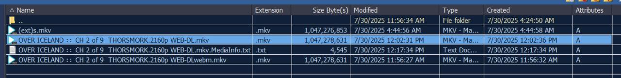

    Download ran at very high speed, around 280Mbps. MediaInfo output attached here. As before, framerate is "Constant 23.976 (24000/1001) FPS".
    Click image for larger version  Name:	YTDL-folder-2.jpg Views:	0 Size:	46.6 KB ID:	465971
    NOTE: Clearly 4K Video Downloader is erroneously creating incorrect and misleading metadata inside its own downloaded file that MediaInfo shows as "Constant 24.000 FPS" if it truly is "Constant 23.976 (24000/1001) FPS".
    Again, thank you very much for all the guidance.

      For some reason MediaInfo file didn't get attached above. Here it is.

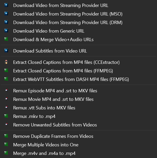

        I have a LOT of scripts to do all kinds of things, so I am used to thinking about double % and also delayed expansions in loops.
        Whenever I encounter a new command-line program with a gazillion options and switches, I ask Gemini or ChatGPT to give me my first syntax and go from there. They are usually about 95% accurate so it cuts down a lot on the time needed to get the exact syntax I want.
        Because of the number of scripts I have, I find that using FileMenu Tools makes life easier, and I don't have to remember what I called the script.
        I just right click on the folder where i want to download or process files and i get a menu of all i can do. I have sections for Comics, Videos, Images, etc...
        Here is what my Videos section looks like:
        The last free version of FMT is v7.0.5. Versions after that are paid. 7.0.5 works just fine for what I need. I got it from here a few years back.
        Here is the script attached to the command at the very top. Maybe it will give you other ideas...I don't really use it anymore as it was mainly to download from DiscoveryPlus and TLC before they added DRM:

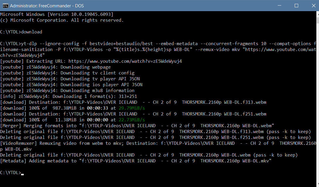

              Anyway, I've now reconsidered and applied one more of your command operand recommendations: --compat-options filename-sanitization
              It wasn't present before, and there are two characters in the video file name that are non-standard. And this same name is propagated into the exported TXT file name produced by MediaInfo.
              This didn't cause me any problems for any tool I used to point to that file, until I tried to attach the MediaInfo TXT file to an email (using my email client program app, Forte Agent, which is not browser-based but a local POP3-type product like Thunderbird, the old Outlook Express, etc.). And it complained about being unable to attach it.
              So I added the --compat operand to cleanse the file name, and recreated​ the MKV, and then recreated the MediaInfo export TXT file. And after this "cleansing" it with the --compat operand sure enough there was no problem attaching it to the email with Agent.

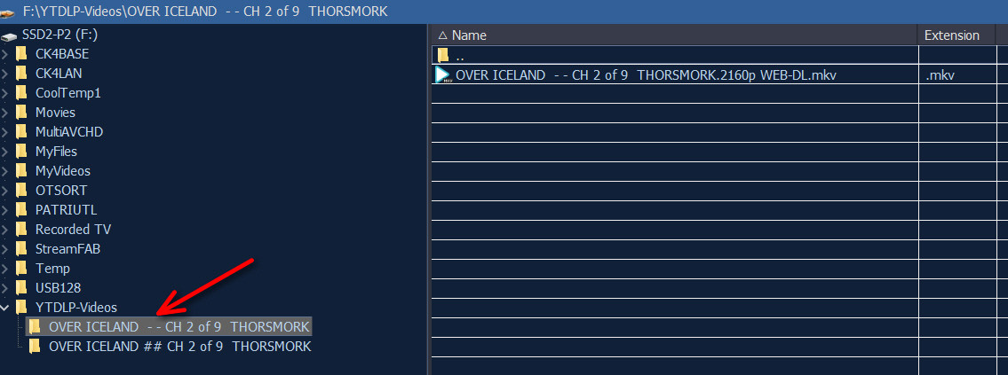

                  I've come back for possible help on one more small issue with my development of my own basic and simple script with no interaction for anything other than the URL, similar to yours, for downloading using yt-dlp.
                  And I also decided that the target location for the downloaded file should go into a properly named sub-folder (within parent F:\YTDLP-Videos) for that video file, having the same name as the downloaded video file which will be placed in it. So the script reflects that objective, making use of yt-dlp to pre-obtain the "video file title" before actually starting the download command. And the retrieved title is then used by the script to fully express the correct -P operand for yt-dlp.
                  Everything is working fine, except that the detail about the "--compat-options filename-sanitization" operand for yt-dlp in the download command itself. This works as expected, and the file name is "cleansed" of the special characters.
                  However there does not seem to be a similar functional equivalent when specifically obtaining the video title through a "yt-dlp --get-title" command. I tried additionally adding the --compat operand which certainly cleanses the file name of the retrieved file, but it has no effect on retrieving the title by itself via --get-title.
                  This isn't terribly critical, but if possible I'd like to have the sub-folder name match the actual name of the stored video file inside. So if the video file name is "cleansed" ideally I'd like to have its host sub-folder name be the same.
                  ==> Is it possible to apply the same cleansing of special characters action done by --compat for the download file name, to the video title returned from --get-title?
                  (apology that this is really a question about yt-dlp rather than StreamFab, but we have kind of wandered OT and you have MUCH EXPERIENCE in script writing specifically related to yt-dlp)
                  thanks.

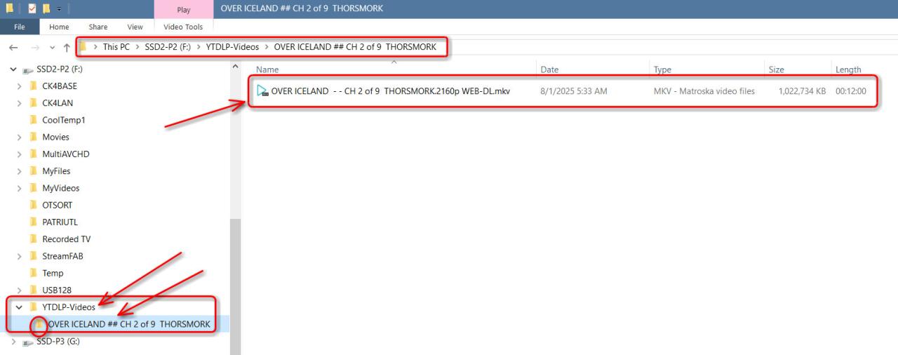

                    Code:
                    -P f:\YTDLP-Videos -o "%%(title)s\%%(title)s.%%(height)sp WEB-DL"
                      #25
                      Also, if you don't want to bother the nice people who read the StreamFab forum, feel free to request to follow me. I'll approve it and then you can DM me
                        #26
                        EXCELLENT! Thank you for that technique. I didn't realize that I could trick the combined syntax of both -P and -o operands to effectively specify the low-level subfolder name that way (with %%(title)s\ at the start), which both (a) creates the sub-folder, and also (b) brings it inside of the domain of the -o operand and the then applicable --compat operand. Very clever.
                        So sure enough, it now creates the properly named sub-folder with the cleansed special characters. Thanks again.
                        Here's the BAT file. Very simple, just prompts for the URL. (Note that the ECHO output of the title is NOT cleansed, although the sub-folder name itself is. Hardly important.)
