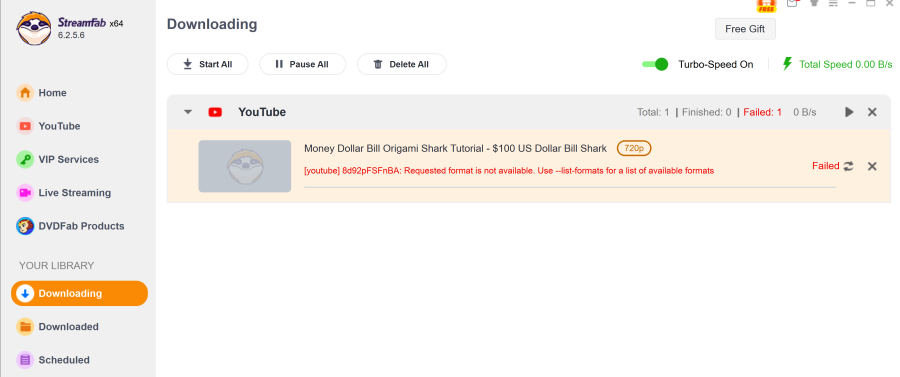

                      I tried the video ( https://www.youtube.com/watch?v=8d92pFSFnBA) and neither 720p nor 1080p works.
                      Get the same error: requested format is not available. Use --list-formats for a list of available formats.

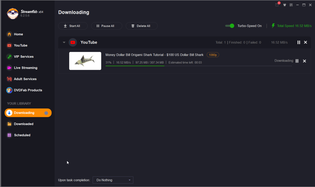

                      ADDED: I did log out of YT in streamfab, and the video works.
                      I may try logging in again to see what happens.
                      Ok, logged back into YT via streamfab and same error trying to download.
                      Requested format is not available. Use --list-formats for a list of available formats
                      So, YES, try logging out of YT via streamfab.

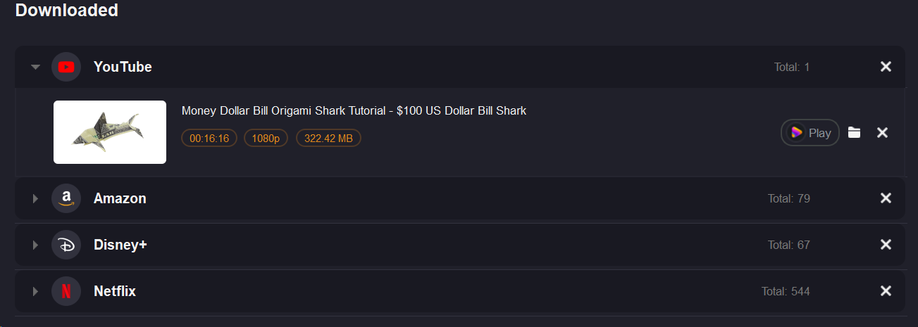

                        6.2.5.6
ID:	468666Click image for larger version
                          I can also download, just need to be logged out of YT. I like to be logged into YT.
                          If logged in to YT, it gives me the error: Requested format is not available. Use --list-formats for a list of available formats.
                          Logged out of YT, no errors or issues, and downloads fine.
