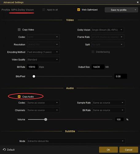

        When using profile MP4.Dolby Vision, did you try Copy Audio?
Name:	copy audio.png

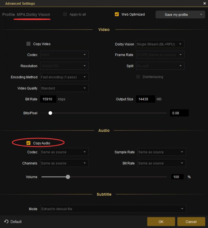

          I can not get Atmos to play using the Dolby Vision profile either, and yes, I did choose Copy Audio in the configuration section of the Dolby Vision profile.
          I'm using Plex to play the file and there's an error that states:
          Transcode Reason: Direct Play was attempted but failed, fallen back to transcoding
          This error is causing Plex to fall back to 5.1DD instead of Atmos.

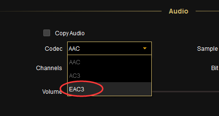

                  MP4 container doesn't support Atmos audio, you can set the audio to EAC3 in the Advanced Settings window.

                    So does this EAC3 format play back Atmos on receivers and tvs that support Atmos?
                    Or is this just a work around to get Atmos on the AppleTV?
                      1, No; 2, No.
                      EAC3 format is relatively better than other available options in this case, so I suggested to use this format.
