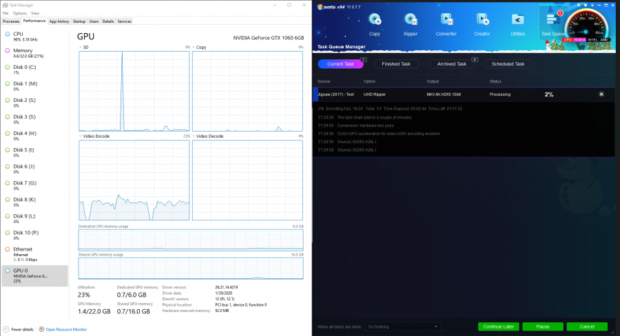

    I have a GTX1060 and I'm trying to figure out if DVDFab is using its full potential, because the task manager is showing that it's only using my GTX1060 for encoding and not decoding. Nvidia states that my videocard is capable of being used for encoding and decoding, but DVDFab isn't doing that. The movie i'm ripping during this test is Jigsaw (2017) UHD disc. I'm using the MKV.4.H265.10bit profile with Copy Audio and render subtitles both selected.
    Here are the some screenshots to you what I'm seeing.
    CPU is maxed out.
    GTX is only being used for encoding at 20%
    No Decoding with GTX.
    Any help in understanding this would be great.
    I'll add the logs when I finished ripping.

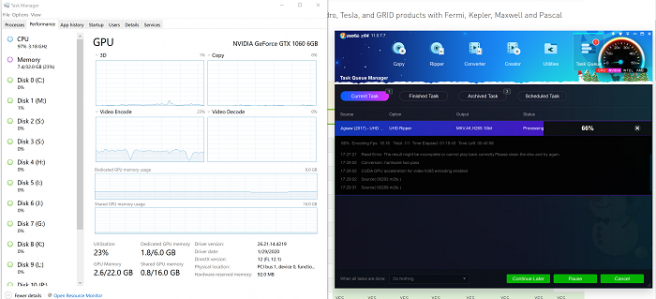

            Here are new screenshots with me ripping the UHD.
            It shows CPU usage at 96%, GPU Encoding at 23%, No GPU Decoding.

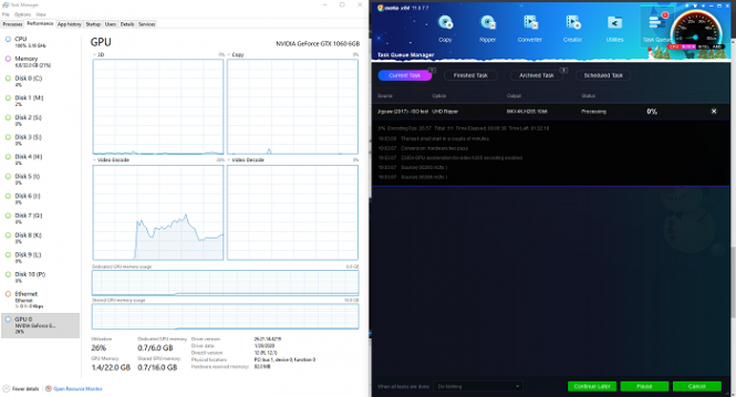

              I copied the ISO from the same movie, Jigsaw (2017), to my pc and ripped it like you suggested and got the same performance or should I say lack there-of.
              The CPU was maxed at 100%, the Encoder was still at 26%, and the Decoder wasn't used.
              As for the screenshots, I've been following the guidelines for submitting photos to the forum: resize photo to 700x500 pixels, then click on image button, select file to upload to server, then click on Center, but as you can see, it becomes very blurry if you try and zoom in.
              Is there a better way to upload photos?
              I've already changed my desktop resolution to 1080P from 4K, but that hasn't helped.

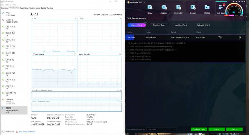

                  Update:
                  I uninstalled all my video card drivers, DVDFab, and my audio drivers, then deleted all files and folders that were connected to those drivers and programs.
                  I then used CCleaner a bunch of times to make sure I cleaned everything.
                  I restarted my pc several times while installing all re-downloaded drivers and programs.
                  I then made sure all settings related to my audio and video were properly set.
                  Did one final restart.
                  Opened DVDFab, adjusted all the settings back to how I had them before. Restarted DVDFab to make sure my settings took.
                  Popped in Jexi (2019) and starting ripping it, and what do you know, my task manager is showing only 80% CPU usage and both Encoding and Decoding usuage!
                  I of course picked the wrong profile to rip with, but hey, at least I got my GPU to do some work finally.
                  No idea what fixed my problem, but here are my logs from this rip.
