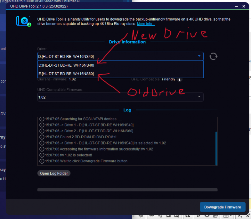

              Thanks but they show in there as the WH16NS60 models now. All my drives are WH16NS40 models.
                The old drives just show as that now after this specific update above.

                      That didn't work either. I also tried the suggestions on this site and it doesn't work. The LG Firmware program won't work either because it sees it as a WH16NS60. This isn't very pleasant. I can't believe DVDFAB's software turned my drives into something else and I can't get them back now. I always wondered why the drives were so loud and grindy sounding and it is because of the other firmware. I bought 2 new WH16NS40 and they don't grind when used.

                          Thank you again, I tried the flasher from there but because the drive identifies itself ad the 60, they don't work. If someone out there has just the .bin file, I can use a flasher tool to flash it. I may just be out of luck.

                              This is kind of what I did and I just fixed them in the last 30 minutes. Thank you for trying to help. I know have four WH16NS40's again.
