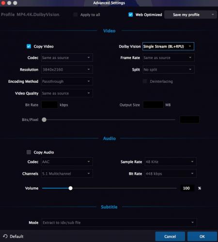

    With MAC v11.0.8.6 I ripped to mp4 using the mp4 option selecting Dolby Vision option. In the 'Advanced Setting' window I selected the Single Stream option in the dolby Vision tab, the copy video box was also checked. I ended up with a DV file, media info below (single video stream)

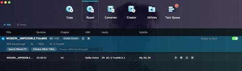

            Once the iso is loaded the options are:
            Profiles:
            1) Choose Other Profile... Options are A) M2TS.Passthrough B) MKV.Passthrough C) MP4.Passthrough
            2) Theater (MP4.Passthrough) No Options
            When I choose the 1st Option "Choose Other Profiles" If I check Dolby Vision with any of the A,B or C options I get sad face "No Matched Profile"
            NOW 11.0.8.6 DOES have a MP4.Dolby.Vision Profile Option
            If I select the Profile MP4 Dolby.Vision, I get MP4 Dolby.Vision option and DolbyVision box checked I can then go to Advanced Settings and select Single Stream or Two Streams.
            NOTE I am using MAC version of DVDFAB

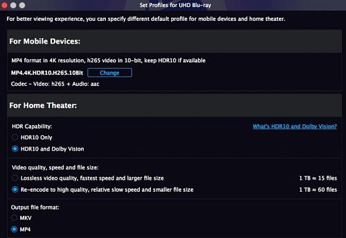

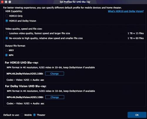

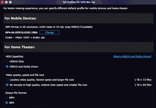

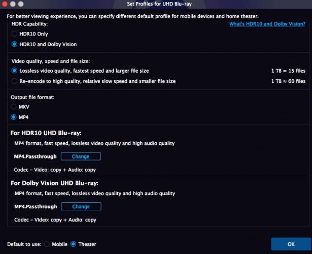

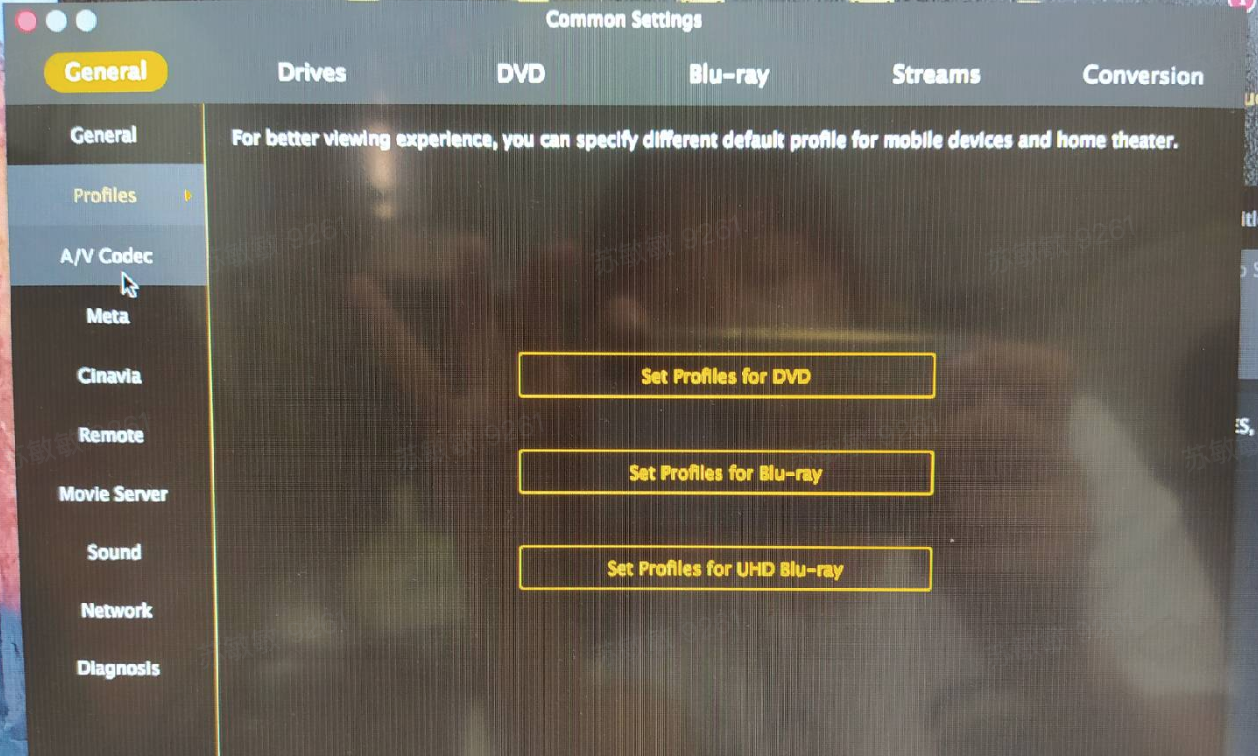

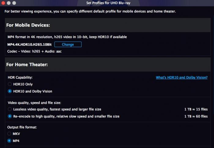

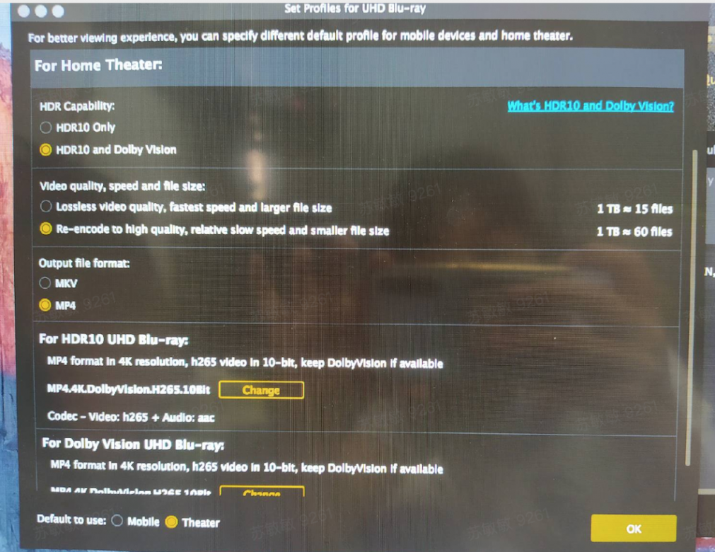

              You can adjust the setting in DVDFab Common Settings > General section. Please check image attached.

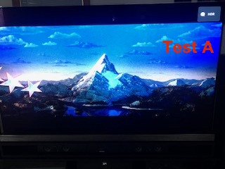

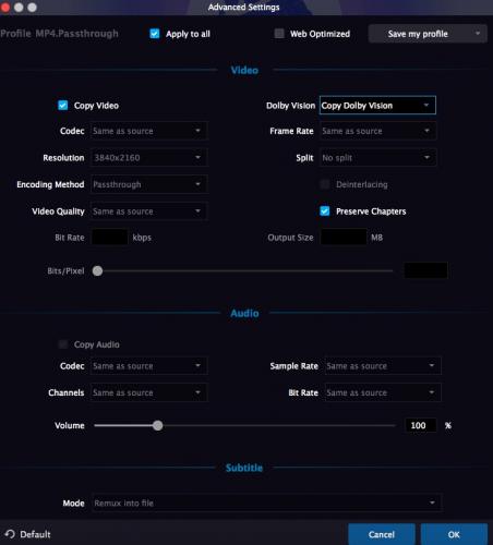

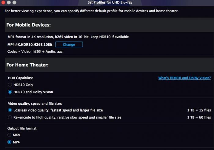

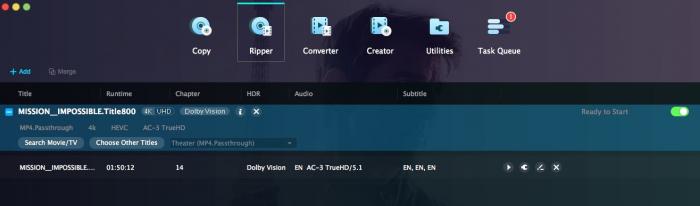

                Test A:
                This was run with MP4 Passthrough with Copy Dolby Vision
                Resulted in a HDR video SEE Attached for details on Test A
                dvdfab_internal.log.txt
                Test A Summary.rtf.txt
                Media Info.rtf.txt
                  Test A continued Screen Grabs:
Name:	Set Profile Upper Portion of Screen.jpg
ID:	383916 Click image for larger version
Name:	Set Profile Lower portion of Screen.jpg
ID:	383917 Click image for larger version
Name:	Main Screen.jpg
ID:	383918 Click image for larger version
Name:	Advance Settings.jpg

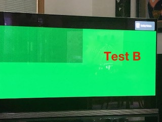

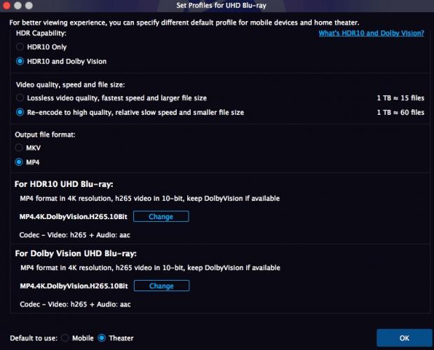

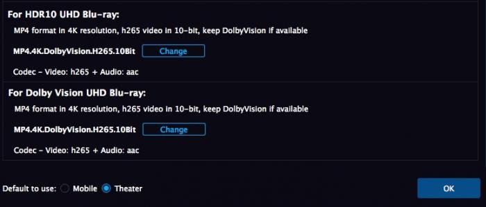

                    Test B:
                    This was run with Re-encoding Dolby Vision
                    MP4.DolbyVision.H265.10bit
                    Single Stream (BL + RPU)
                    See attached files
                    Note in DVDFAB internal Log I had to delect fifo lines in order to make package < 2MB
                    Results was a DolbyVideo source recognized by TV but color was Green and not a stable image
                    dvdfab_internal(Test-B).log.txt
                    Test B summary.rtf.txt
                    Media Info.rtf.txt

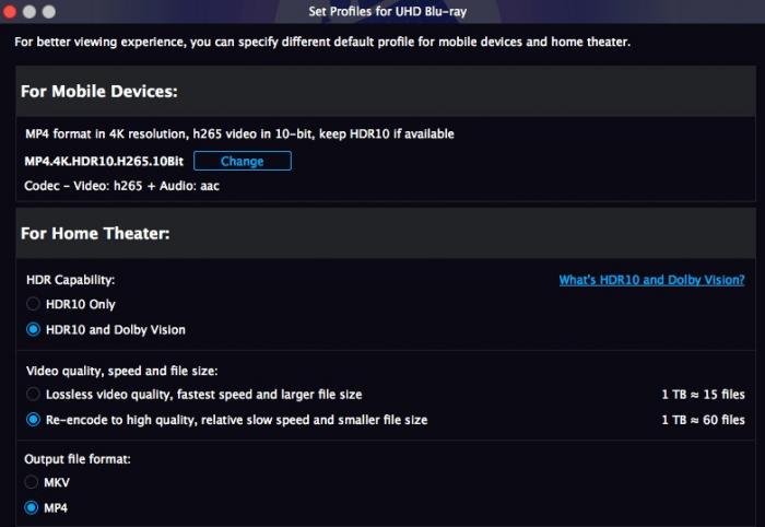

                      Test B :
                      Screen Grab
Name:	Set Profile Upper Portion.jpg
ID:	383925 Click image for larger version
Name:	Set Profile Lower Portion.jpg
ID:	383926 Click image for larger version
ID:	383927 Click image for larger version
Name:	Advanced Setting.jpg

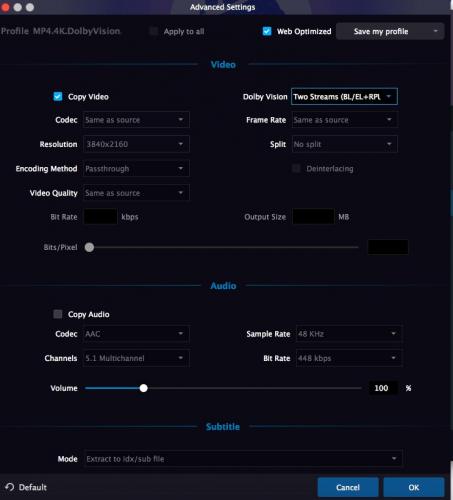

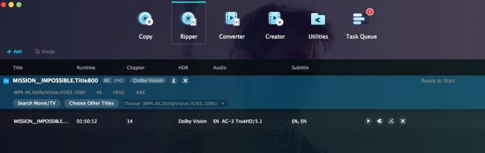

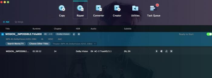

                        Test C:
                        Two Stream (BL/EL + RPU)
                        See attached files
                        Results was a DolbyVideo source recognized by TV but color was Green and a stable image
                        dvdfab_internal(Test C).log.txt
                        Test C summary.rtf.txt
                        Media Info.rtf.txt
                          Test C:
                          Screen Grab
ID:	383934 Click image for larger version
ID:	383935 Click image for larger version
ID:	383936 Click image for larger version
Name:	Advance Setting.jpg
                            Screen Grab from TV for Test A,B & C
ID:	383939 Click image for larger version
ID:	383940 Click image for larger version
