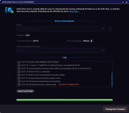

    When I attempted to copy a newly purchased 4K UHD movie (Midway) I was prompted by DVDFab 12 that the firmware on my BUFFALO UHD BD Portable Blu-ray Drive Black BRUHD-PU3-BK was not the correct one. Even though I used the drive to copy a movie yesterday, I followed the instructions to downgrade the firmware using the UHD_Drive_Tool2. The tool has now been running for over an hour. The first time I used the tool to flash the firmware it took less than 2 minutes. I am attaching a snip of the Tool screen and the UHD_Drive_Tool2 log. I don't want to turn off the computer and risk losing the brand new Buffalo drive, hopefully someone smarter out there can help me. [ATTACH]n388813[/ATTACH] Click image for larger version

    The downgrade has actually finished successfully, you can use it to play and copy with DVDFab products now.
    The hangup issue is a UI issue, we will fix it as soon as possible.
