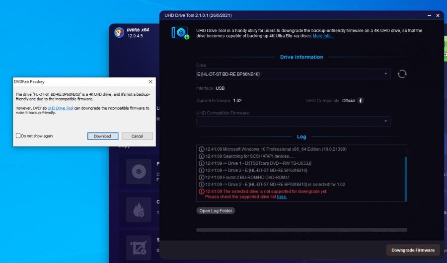

HL-DT-ST BD-RE-BP60NB10 - Passkey says Yes to Upgrade, DriveTool says No

    As the topic title says... Passkey says the drive is upgradeable but Drive Tool says no. This is a wee bit distressing after purchasing DriveTool at the advice of Passkey.
    True that the site doesn't specifically mention this drive but since Passkey suggested it I guessed, incorrectly that DriveTool would work. Is this drive slated to get support any time in the future?

      Here's the latest
      UHD Drive Tool 2.1.0.1(2021/09/14 10:39:44) x64
      2021.09.14-10:39:44: Init CrashReportSettings: enabled.
      2021.09.14-10:39:44: Set backup path: C:\Users\vince.UTOPIA\Documents\DVDFab\DVDFab12\Te mp\UHD_Drive_Tool\.
      2021.09.14-10:39:44: SetAcccountInfo success!!
      2021.09.14-10:39:44: SetUserTokenInfo success!!
      2021.09.14-10:39:45: Clear Drive List.
      2021.09.14-10:39:45: Tool internal v=4
      2021.09.14-10:39:45: Initial Drive List.
      2021.09.14-10:39:45: Run As Admin.
      2021.09.14-10:39:45: get mask of logical drives
      2021.09.14-10:39:45: DiEnum Device Info.
      2021.09.14-10:39:45: DiEnum Device Info end.
      2021.09.14-10:39:45: UHD Drive Tool 2.1.0.1 started!
      2021.09.14-10:39:45: Registered User: Feature enabled.
      2021.09.14-10:39:45: Microsoft Windows 10 Professional x86_64 Edition (10.0.21390)
      2021.09.14-10:39:45: check drive type.
      2021.09.14-10:39:45: Searching for SCSI / ATAPI devices......
      2021.09.14-10:39:45: get drive list num = 3.
      2021.09.14-10:39:45: Open Drive Type = 0
      2021.09.14-10:39:45: Open Drive 1 OK.
      2021.09.14-10:39:45: Read Drive Firmware.
      2021.09.14-10:39:45: Read Ioctl info.
      2021.09.14-10:39:45: Got Drive Firmware error.
      2021.09.14-10:39:45: Drive Lities = 0.
      2021.09.14-10:39:45: Drive Lities = 3.
      2021.09.14-10:39:45: get drive list end.
      2021.09.14-10:39:45: Sata mode: D, SCSI.
      2021.09.14-10:39:45: Get Firmware List
      2021.09.14-10:39:45: -> Drive 1 - D:[TSSTcorp DVD+-RW TS-U633J]
      2021.09.14-10:39:45: Firmware info error
      2021.09.14-10:39:45: Got Firmware Count = 0
      2021.09.14-10:39:45: Init firmware list success
      2021.09.14-10:39:45: Sata mode: E, N/A.
      2021.09.14-10:39:45: -> Drive 2 - E:[HL-DT-ST BD-RE BP60NB10]
      2021.09.14-10:39:45: request Firmware List
      2021.09.14-10:39:45: Firmware:HL-DT-ST|BD-RE BP60NB10 |BU3
      2021.09.14-10:39:45: request Firmware List Ok
      2021.09.14-10:39:45: Found 2 BD-ROM/HD DVD-ROMs!
      2021.09.14-10:39:45: -> Drive 2 - E:[HL-DT-ST BD-RE BP60NB10] is selected! fw 1.02
      2021.09.14-10:39:45: The selected drive is not supported for downgrade yet.
      Please check the supported drive list <a href ="https://www.dvdfab.cn/tips/supported-drive-list.htm?clientusertype=paid" style='color: #00aeff;'> here.</a>
        Hello, the developer confirms that the drive HL-DT-ST|BD-RE BP60NB10 (fw: BU3) is not supported. There is no solution at the moment.
