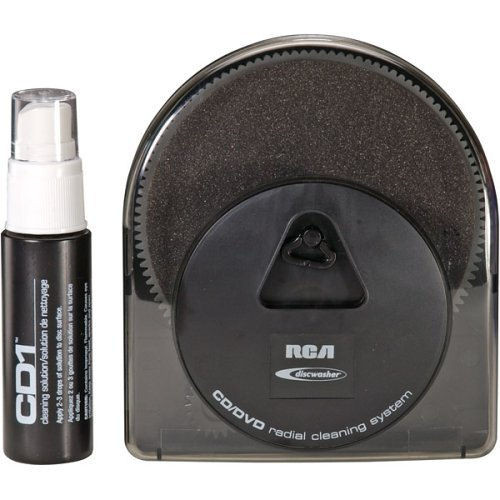

              my personal experience and opinion . . no guarantees . .
              when I think the lens in my drive (or optical disk player) may be a problem, I use a new q-tip soaked in denatured alcohol to wipe the lens and area clean. - then I use a can of compressed air to ensure the alcohol has been dried off.
              More likely is the disc . . I use my old discwasher disc cleaner to clean the disc and then try again . .
                thank you both. this worked. 3rd time was the charm.
