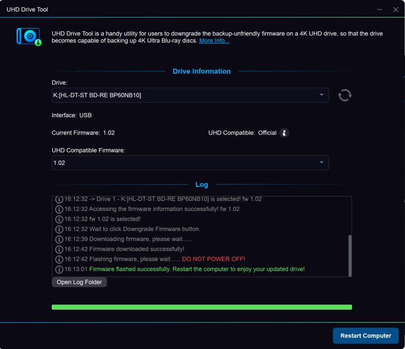

Impossible to downgrade a BP60NB10 driver with UHD Drive Tool
    UHD Drive Tool Impossible to downgrade a BP60NB10 driver with UHD Drive Tool
    UHD_Drive_Tool2.log I own a BD-RE BP60NB10 driver that I want to downgrade with UHD Drive Tool.
    Click image for larger version  Name:	image.png Views:	4 Size:	116.8 KB ID:	464363
    The tool claims that the firmware has updated fine, but the drive then is not recognized as being UHD friendly.
    Click image for larger version  Name:	image.png Views:	4 Size:	54.9 KB ID:	464362
    Any help is welcome.

    2025.06.18-15:17:36:
    UHD Drive Tool 1.0.0.1(2025/06/18 15:17:36) x64
    2025.06.18-15:17:36: Init CrashReportSettings: enabled.
    2025.06.18-15:17:36: Set backup path: C:\Users\tdptdb\Documents\DVDFab\DVDFab13\Temp\UHD _Drive_Tool\.
    2025.06.18-15:17:36: SetAcccountInfo success!!
    2025.06.18-15:17:36: SetUserTokenInfo success!!
    2025.06.18-15:17:37: Clear Drive List.
    2025.06.18-15:17:37: Tool internal v = 9
    2025.06.18-15:17:37: Initial Drive List.
    2025.06.18-15:17:37: Run As Admin.
    2025.06.18-15:17:37: get mask of logical drives
    2025.06.18-15:17:37: DiEnum Device Info.
    2025.06.18-15:17:37: DiEnum Device Info end.
    2025.06.18-15:17:37: check drive type.
    2025.06.18-15:17:37: get drive list num = 12.
    2025.06.18-15:17:37: Open Drive Type = 0
    2025.06.18-15:17:37: Open Drive 1 OK.
    2025.06.18-15:17:37: Read Drive Firmware.
    2025.06.18-15:17:37: Read Ioctl info.
    2025.06.18-15:17:37: Drive Lities = 3.
    2025.06.18-15:17:37: UHD Drive Tool 1.0.0.1 started!
    2025.06.18-15:17:37: Got Drive Firmware error.
    2025.06.18-15:17:37: Registered User: Feature enabled.
    2025.06.18-15:17:37: Drive Lities = 0.
    2025.06.18-15:17:37: Microsoft Windows 10 (10.0) Professional x86_64 Edition (10.0.19045)
    2025.06.18-15:17:37: get drive list end.
    2025.06.18-15:17:37: Searching for SCSI / ATAPI devices......
    2025.06.18-15:17:37: Sata mode: K, N/A.
    2025.06.18-15:17:37: Get Firmware List
    2025.06.18-15:17:37: request Firmware List
    2025.06.18-15:17:37: Get Drive Info!
    2025.06.18-15:17:37: -> Drive 1 - K:[HL-DT-ST BD-RE BP60NB10]
    2025.06.18-15:17:39: Firmware:HL-DT-ST|BD-RE BP60NB10 |BU3
    2025.06.18-15:17:39: request Firmware List Ok
    2025.06.18-15:17:39: Got Firmware
    2025.06.18-15:17:39: Got Firmware HL-DT-ST-BD-RE BP60NB10 -1.02 - 1
    2025.06.18-15:17:39: Got Firmware Count = 1
    2025.06.18-15:17:39: Init firmware list success
    2025.06.18-15:17:39: Sata mode: M, SCSI.
    2025.06.18-15:17:39: Get Firmware List
    2025.06.18-15:17:39: -> Drive 2 - M:[hp HLDS DVDRW GUD0N]
    2025.06.18-15:17:39: Firmware info error
    2025.06.18-15:17:39: Got Firmware Count = 0
    2025.06.18-15:17:39: Found 2 BD-ROM/HD DVD-ROMs!
    2025.06.18-15:17:39: -> Lecteur 1 - K:[HL-DT-ST BD-RE BP60NB10] is selected! fw 1.02
    2025.06.18-15:17:39: Accessing the firmware information successfully! fw 1.02
    2025.06.18-15:17:39: fw 1.02 is selected!
    2025.06.18-15:17:39: Wait to click Downgrade Firmware button.
    2025.06.18-15:18:32: Refreshing the drive list......
    2025.06.18-15:18:32: Clear Drive List.
    2025.06.18-15:18:32: Close Drive.
    2025.06.18-15:18:32: UHD Drive Tool 1.0.0.1 started!
    2025.06.18-15:18:32: Registered User: Feature enabled.
    2025.06.18-15:18:32: Microsoft Windows 10 (10.0) Professional x86_64 Edition (10.0.19045)
    2025.06.18-15:18:32: Searching for SCSI / ATAPI devices......
    2025.06.18-15:18:32: Tool internal v = 9
    2025.06.18-15:18:32: Initial Drive List.
    2025.06.18-15:18:32: Run As Admin.
    2025.06.18-15:18:32: get mask of logical drives
    2025.06.18-15:18:32: DiEnum Device Info.
    2025.06.18-15:18:32: DiEnum Device Info end.
    2025.06.18-15:18:32: check drive type.
    2025.06.18-15:18:32: get drive list num = 12.
    2025.06.18-15:18:32: Open Drive Type = 0
    2025.06.18-15:18:32: Open Drive 1 OK.
    2025.06.18-15:18:32: Read Drive Firmware.
    2025.06.18-15:18:32: Read Ioctl info.
    2025.06.18-15:18:32: Drive Lities = 3.
    2025.06.18-15:18:32: Got Drive Firmware error.
    2025.06.18-15:18:32: Drive Lities = 0.
    2025.06.18-15:18:32: get drive list end.
    2025.06.18-15:18:32: Sata mode: K, N/A.
    2025.06.18-15:18:32: Get Firmware List
    2025.06.18-15:18:32: -> Drive 1 - K:[HL-DT-ST BD-RE BP60NB10]
    2025.06.18-15:18:32: request Firmware List
    2025.06.18-15:18:32: Get Drive Info!
    2025.06.18-15:18:33: Firmware:HL-DT-ST|BD-RE BP60NB10 |BU3
    2025.06.18-15:18:33: request Firmware List Ok
    2025.06.18-15:18:33: Got Firmware
    2025.06.18-15:18:33: Got Firmware HL-DT-ST-BD-RE BP60NB10 -1.02 - 1
    2025.06.18-15:18:33: Got Firmware Count = 1
    2025.06.18-15:18:33: Init firmware list success
    2025.06.18-15:18:33: Sata mode: M, SCSI.
    2025.06.18-15:18:33: Get Firmware List
    2025.06.18-15:18:33: -> Drive 2 - M:[hp HLDS DVDRW GUD0N]
    2025.06.18-15:18:33: Firmware info error
    2025.06.18-15:18:33: Got Firmware Count = 0
    2025.06.18-15:18:33: Found 2 BD-ROM/HD DVD-ROMs!
    2025.06.18-15:18:33: -> Lecteur 1 - K:[HL-DT-ST BD-RE BP60NB10] is selected! fw 1.02
    2025.06.18-15:18:33: Accessing the firmware information successfully! fw 1.02
    2025.06.18-15:18:33: fw 1.02 is selected!
    2025.06.18-15:18:33: Wait to click Downgrade Firmware button.
    2025.06.18-15:19:51: Get Firmware List
    2025.06.18-15:19:51: request Firmware List
    2025.06.18-15:19:51: Get Drive Info!
    2025.06.18-15:19:51: Firmware:HL-DT-ST|BD-RE BP60NB10 |BU3
    2025.06.18-15:19:51: request Firmware List Ok
    2025.06.18-15:19:51: Got Firmware
    2025.06.18-15:19:51: Got Firmware HL-DT-ST-BD-RE BP60NB10 -1.02 - 1
    2025.06.18-15:19:51: Got Firmware Count = 1
    2025.06.18-15:19:51: GetFirmWareTypeFromID IsRelease : 1
    2025.06.18-15:19:54: Start Downgrading
    2025.06.18-15:19:54: Close Drive.
    2025.06.18-15:19:54: Get Drive Info!
    2025.06.18-15:19:54: Downloading firmware, please wait......
    2025.06.18-15:19:57: MOD v = 2L-DT-ST
    2025.06.18-15:19:57: Download Firmware end.
    2025.06.18-15:19:57: Firmware downloaded successfully!
    2025.06.18-15:19:57: Flashing firmware, please wait......<a style='color: #f74444;'> DO NOT POWER OFF!</a>
    2025.06.18-15:19:57: DE:1a8c334a3d1770651cd0794f7434a468
    2025.06.18-15:19:58: Crypto policy: - (Mod)
    2025.06.18-15:20:16: Flash re = 1
    2025.06.18-15:20:16: wrire drive flash end.
    2025.06.18-15:20:16: <a style='color: #5FDE5F;'> Firmware flashed successfully. Restart the computer to enjoy your updated drive!</a>

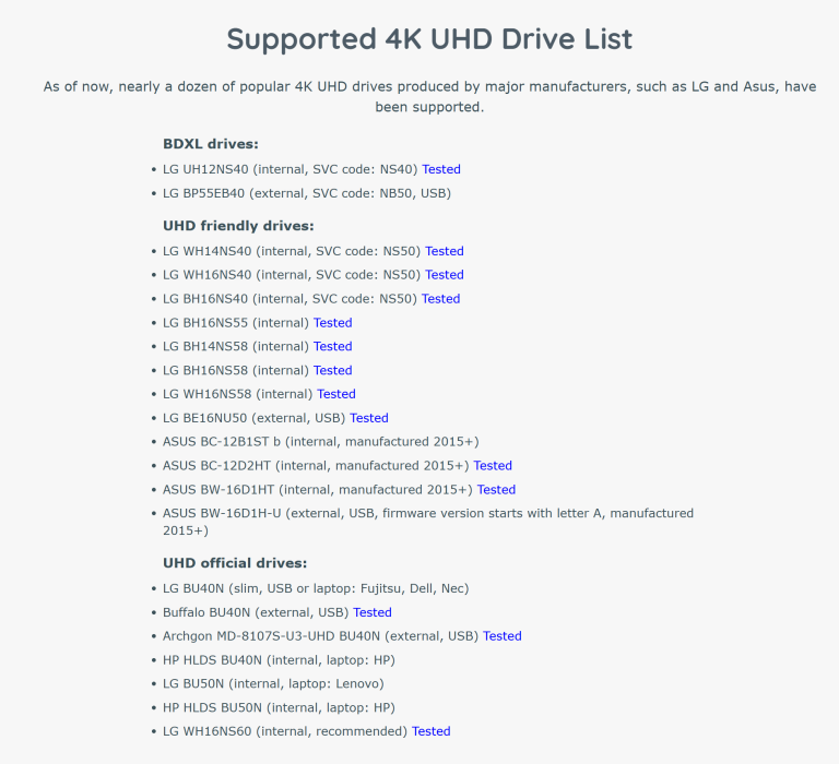

    I am not seeing your BP60NB10 drive on the list of supported 4k Friendly drives.
    Based on the supported drive list, this post describes how to downgrade firmware on 4K UHD unfriendly drives to a friendly version for legal backups.

        When you check the US page about this software, here are the supported drivers:

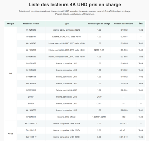

        When you check the French page, many drivers are mentioned (also the BP60NB10):
        So the question is: is the BP60NB10 a supported 4K UHD drive ?
            Click image for larger version  Name:	image.png Views:	0 Size:	143.7 KB ID:	464381
            Click image for larger version  Name:	image.png Views:	0 Size:	121.0 KB ID:	464382
