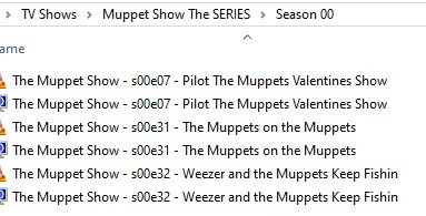

    I attempted trying to put my first "extras" into Season 0 where I looked up on TMDB and matched what I was trying to get working. However when updating the library - none of them were found. Note I've tried "Season 0" and "Season 00" and neither works....same for s00e07 vs. s0e7.
    Any ideas if they are on TMDB why the scraper doesn't find these? Note the scrapper found the Season 02 episodes just fine.

    The three movies from your attached files that you are having a problem with. The only one that really is a pilot is:
    The Muppet Show - Pilot - The Muppets Valentines Show...the other two are not noted as being a pilot/special in any of seasons as episodes. Believe they were just bonus features that were added with Season Two Box set. Just a bit of history on Weezer and the Muppets Keep Fishin'. and why it will never show up on the movie sever.
    https://muppet.fandom.com/wiki/Weeze...s_Go_Fishin%27
    For The Muppet Valentines Show, try.... labeling it like this.....The Muppet Show - s00e07 - Pilot - The Muppets Valentine Show...........(notice the dash between - Pilot and the Title)
    About why it's on the TDMB and listed as episodes as such is wrong, someone listed it as such but it's not the official list, you can't create a list on TDMB or TVDB if there is already one that is listed, in this case The Muppet Show was mostly part a TV series and not movies as listed even though if you want to call a special a movie you can. Believe it was already listed as a TV series first when someone decided to upload there list on the TDMB, so the TDBM is not the official list for it, the correct series listed is on the TVDB as noted.
    https://thetvdb.com/series/the-muppe...ons/official/0
    s00s07 -Pilot - The Muppets Valentine Show, should show up....the other two not sure you will ever get them to show up.

      I tried renaming. It is still not recognized.
      For a system that is sooooooo dependent on TMDB - I can't imagine it is actually determining which episodes are pilots or not. I figure as long as it is in TMDB, it should be recognized.. However this is my first attempt at "Season 0" so I guess anything's possible.
      Also, just as an FYI (and I'm not saying your wrong, only that my research had shown this) that at some point in recognizing the file name string, it drops the remainder of the name and therefore that part shouldn't have a factor in matching. I thought that this was the case as the end of the string and that the name of the show/episode was treated this way, which means that it could be called anything and should be dependent on the name, directory name, TV/Movie Directory, and sXXeXX. I've sort of noted this seems to be true in my dealing with my other problems.
