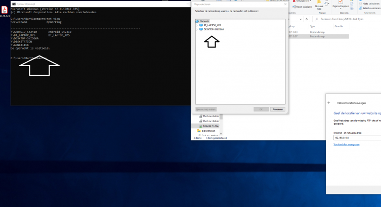

      Mapping this drive doesn't work. I can ping the MS, I can view it via net view but I cannot view it by adding network location. SMB 1 enabled. Checked the flags via powershell.
      See attachment...

        So the 'Add Network Location' function doesn't work then?
          Originally posted by BartGoem View Post
          Thanks but tried that before posting this thread...
          See attachment...
          Txs,
          B.
