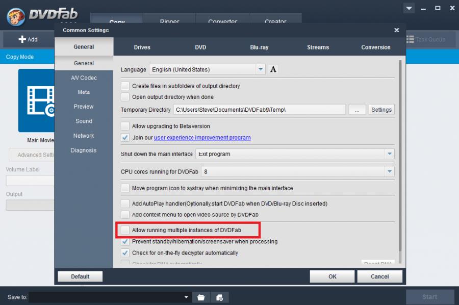

    Yeah just check this box in common settings and run multiples of Fab.

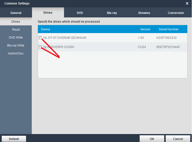

        Greg, uncheck all drives in common settings and it won't autoscan the discs, you can add each drive manually to each instance.
