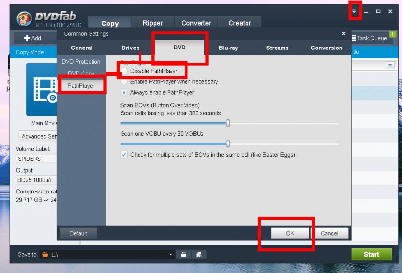

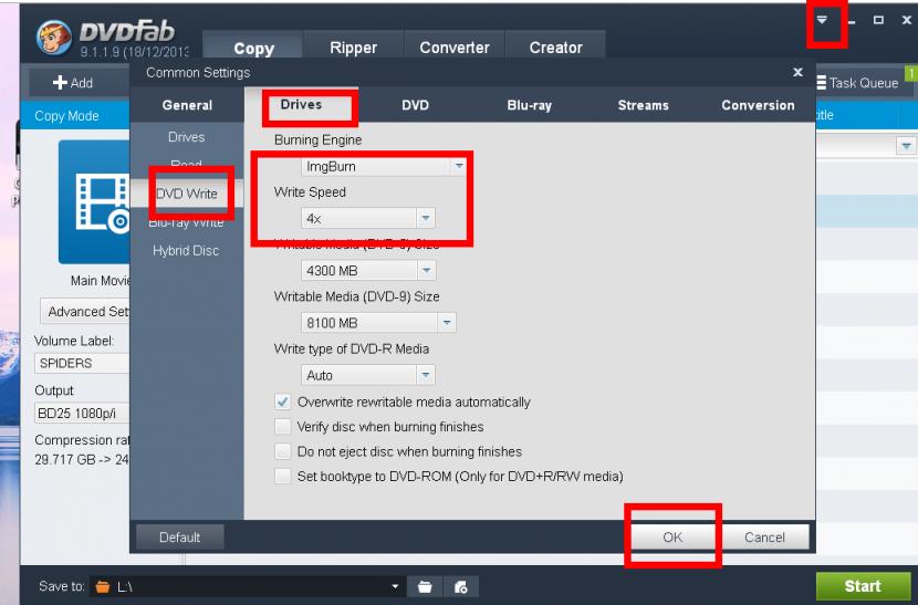

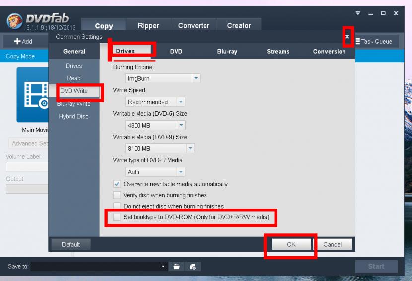

        You didn't post the fabburn log but I will take a good guess here seems their are 4 shows on a disk so try turning pathfinder off in Fab settings and try again just for this disk that give you trouble like this one, when done turn it back on.
          I am really sorry about being so dense. But when I go to General tab under Common settings I don't find Pathfinder. It lists Genreal A/V Codec, Preview, Sound, Network, Diagnosis.
          Also the version 9 is very different looking that the Version 8.

            See DVD on the top bar see screen shot make sure you click dvd for dvd settings ok.Also your burn rate is 8x your burning speed is set too fast burn at 1/2 disk rated speed 4x for this disk.Also if you use plus r disks like you have now check the box in screen shot #15 to make them play better on different machines.
