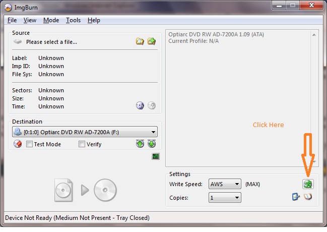

      Also this is most likely your problem provided your player supports the media your using, from the ImgBurn log
      I 12:38:35 Write Speed: MAX
      Watch Troy512's video again on how to set up ImgBurn to work with Fab and to set the AWS (automatic Write Speed).

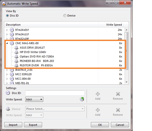

                    Just to comfirm check my attached pics to see if yours is the same for your aws in ImgBurn.
