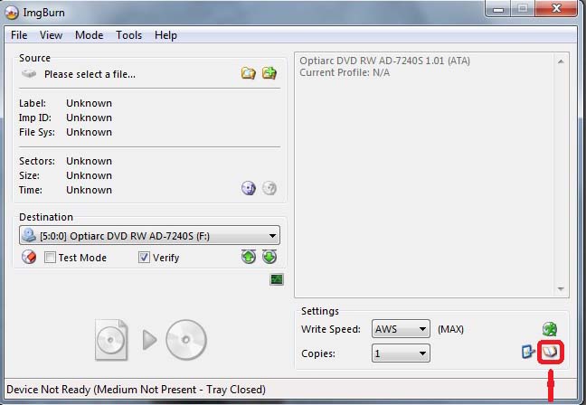

              Personally, I use ImgBurn in standalone mode (not from within DVDFab) for all burning. It has superior control over the layer break positioning and extensive support for bitsetting on many optical drives. I'm still not sure if your problem is incorrect (or lack of) bitsetting on your burned discs. You need some other DVD tools (like DVDInfoPro, ISOBuster, etc.) to make sure the discs are finalized correctly and burned to look like DVD-ROMs to your player. ImgBurn has a utility (under the Tools menu) that will attempt to fix a disc that was not finalized properly.

                    I followed the instructions as MAINEMAN suggested to setup IMAGE BURN and DVDFAB to work together and still the same issue.

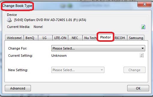

                      You also are not bitsetting this media +R to DVD-ROM
                      As signals mentioned above, this may or may not be part of the problem.
                      I suspect it is as the discs play in your burner, but not your standalone player, no way to tell for sure based on the info.
                      Please bitset (change the booktype of your blank media and give it another shot.

                            I tried changing the Book-Type to DVD+R Media and this is what happened:
                            FAILED
                            REASON: Invalid Command Operation Code
