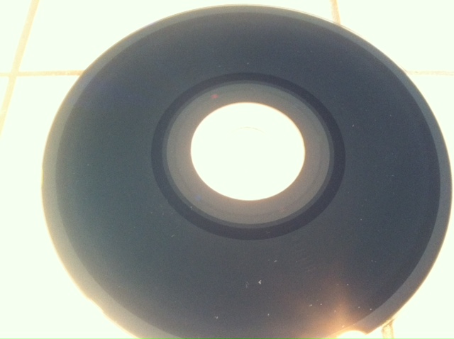

          Attached is a picture of what is happening to my burns on my LG.
          (This pic is a more 'extreme' case as I burned it at max speed.)
          Normally I like to burn at 1 or 2x because the quality of the burn is better (deeper, whatever you want to call it)
          Notice the rings I get.
          On a 1 or 2x burn.. I might get one bad spot...
          Its just not right.
          I also have 50GB Verbatim discs that I was using for backing up my 3D discs. but they too seem to be getting lots of rings lately.

          LG - BH12L38 is what I have.. firmware doesnt go past 1.00

                          The last part that you metion about '...the last few chapters...' is what is happening to me.
                          What you say makes sense... and my burner is a couple years old and has LOTS of miles on it... maybe its time to swap out...
                            Ordered an Asus 12x burner from Tiger direct for $89 - and supposedly has a $20 rebate.
                            We'll see how good this one is.
                              Been using it for a couple weeks now, and have not had the problems I had with the previous burner. If I look at the underside of the disc after a burn, I can still make out burn rings.. (slightly)
