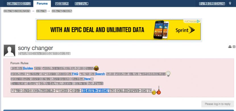

                  Tried imgburn - I see where it has the Batch feature - but it does not recognize the carousel - so It finished 1 disc, then would not advance - just asked if I wanted to overwrite the disc it just ripped. I think I am going to continue to try to cmd line dvdfab since it is close
                    I am using a sony vaio changer and i go into the media changer and nothing comes up, so i select the sony vaio changer and it says it has 200 slots but everything is unknown and when i click scan all it does nothing with the changer at all. Like it can't control it for some reason. I use a dos pr...
                      Gummigutta - Thank You! ImgBurn looks interesting- from the pictures it looks like it works - but I have a font thing going on on my mac right now and could not read any of it. I will read that thread soon.
